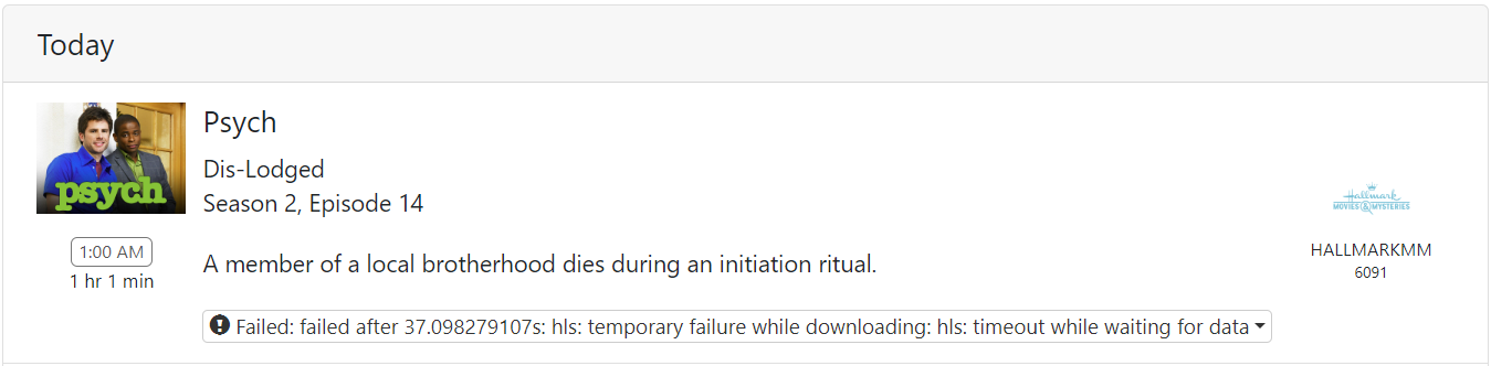

Recording stopped early ("hls: timeout while waiting for data")
What caused this recording (Psych S02E14) to stop early?
Can anything be done to make this less likely to happen again?

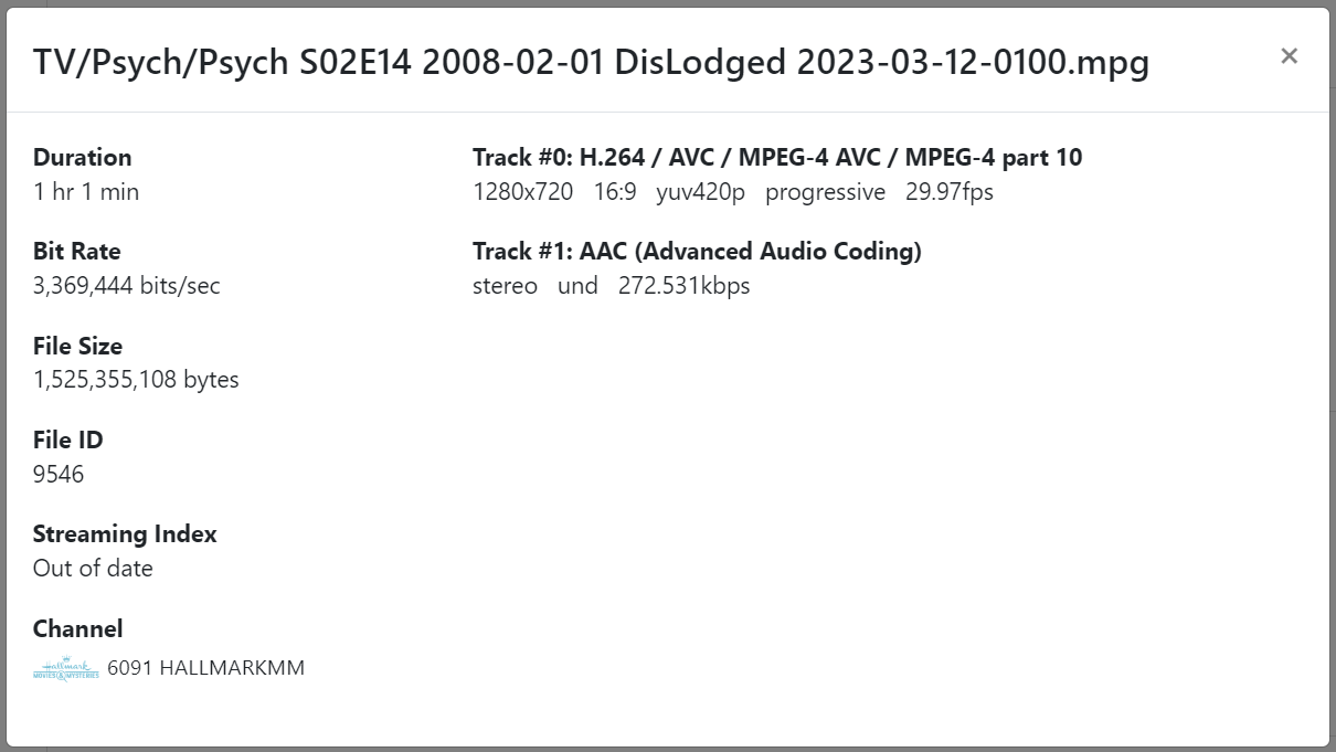

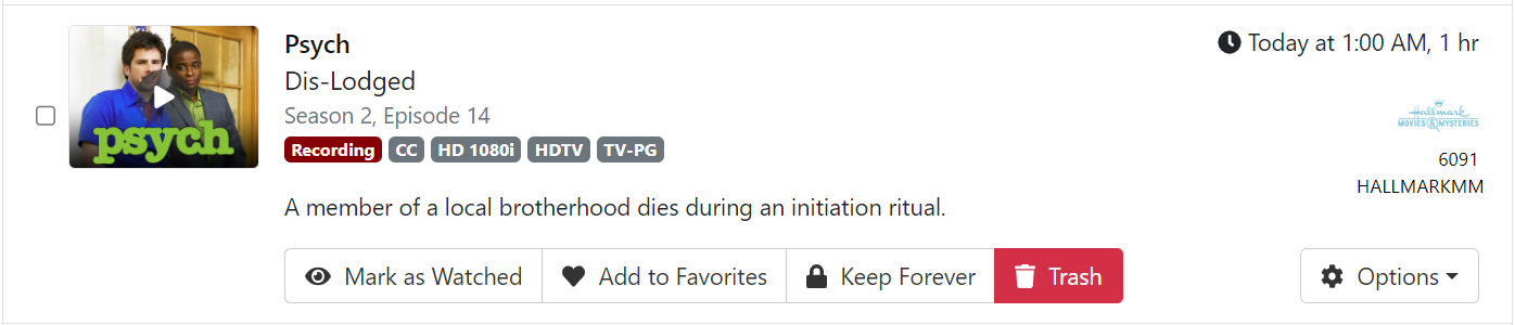

It would also be nice if it wasn't still incorrectly marked as "Recording."

2023/03/12 03:00:46.293207 [DVR] Error running job 1678600800-269 Psych: failed after 37.098279107s: hls: temporary failure while downloading: hls: timeout while waiting for data

Weird. Does look like it recorded 01:00:23 of 01:00:30 though.
[MTS] Statistics ... highest_pts=3623.022133 = 3,623 seconds

I've reported a few of those. Still have one in my Library. Fails to complete the full recording and gives up, leaving it marked as still Recording.
It did not.
As far as I can tell, the last line in my logs above is the last mention of anything related to this recording.
