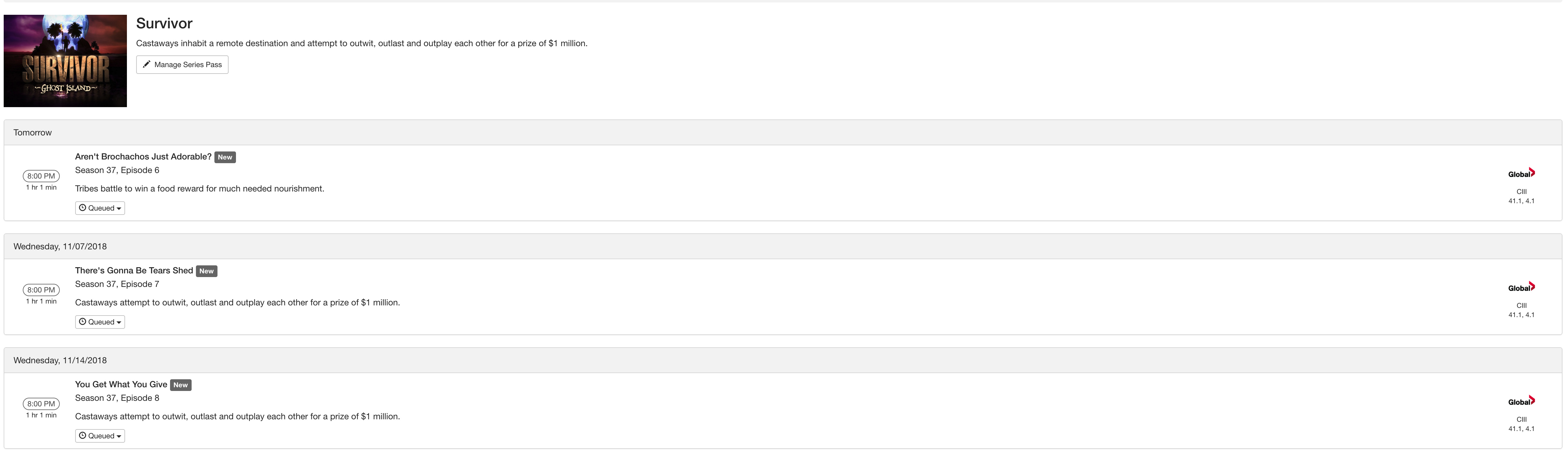

Huh, so two different new episodes are airing at the same time?
If there is only one entry in the schedule then that means the guide data is saying it's going to be the same episode.
Can you post screenshots of the DVR web UI schedule, and the search results for survivor upcoming episodes
no i mean same episodes airing at the same time on 2 different channels, i like to record both in case one record have pixelation problem, now i can do it manually but i dont want to have to do it every week because i may forget to do it

Unfortunately there is no easy way to do this.
Do you sometimes have pixelation on both channels? If one is more stable then you can edit the pass on the web UI to add a channel and force that channel to be used for the pass.
im sorry but thas is no good, is there anything you guys can do to be able to do this, all my cable boxes just to do it, and i believe i will double check that i can do it on tvheadend, that is what record all episodes suppose do it
