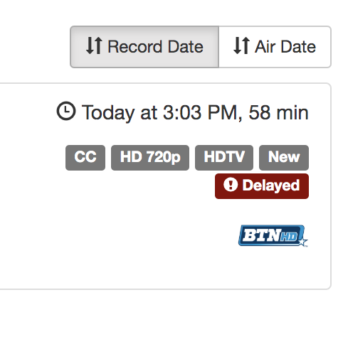

I’m having the same issue. Many of my recordings have the “Recording was started late” warning. Even games that I watched live and I still have the beginning of the game in my client’s buffer have the first 5-15 min missing in the DVR.

Thanks. Here are the logs for the last time this happened. It's job 1573502400-8 on BTN.

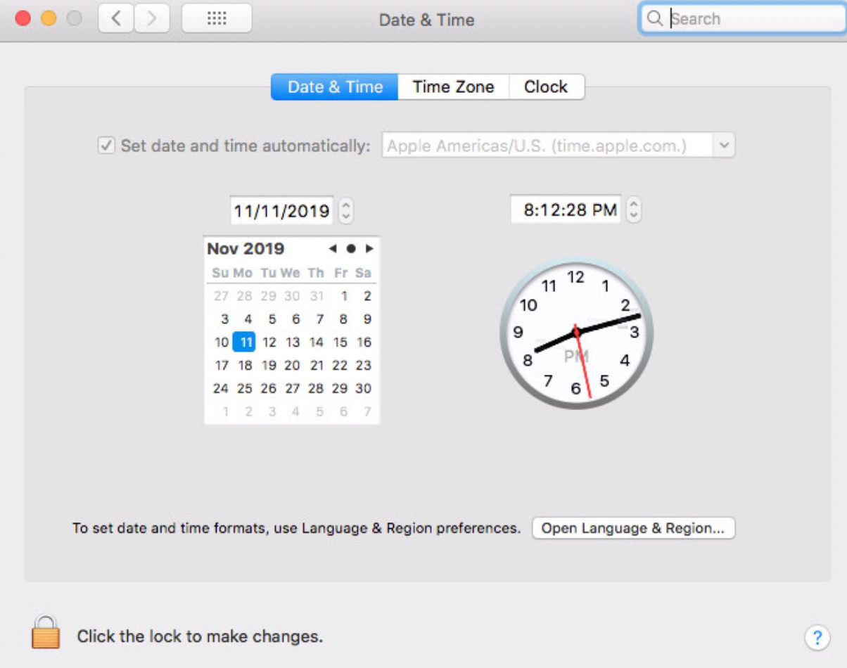

Do you have "set date and time automatically" enabled in system preferences?
What version of macOS?
10.13.6
