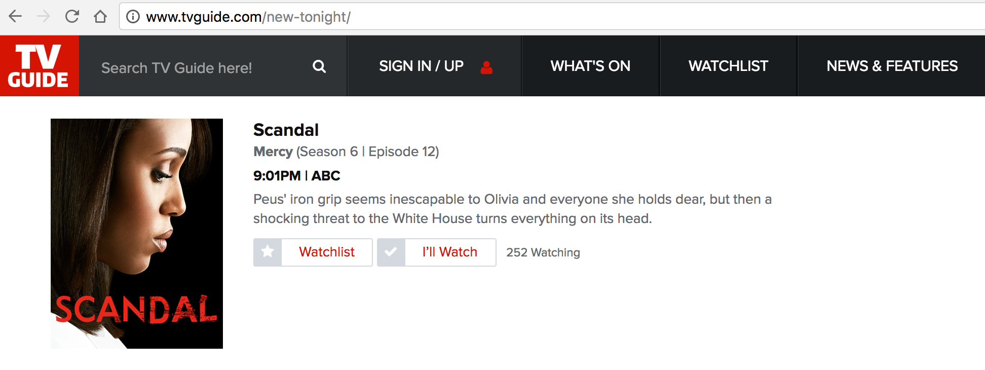

I'm pretty sure Scandal starts at 9:01 tonight, and is only 59min. I see the same thing on http://www.tvguide.com/new-tonight/
