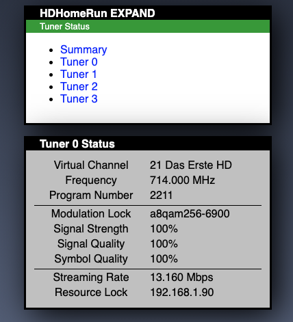

I see your signal strength as 100%. Is it possible that the tuner is having issues by an over-powered signal? Is the problem only on channel 21? Also, the seq totals in the SNR stats line for the stream show that there were errors.
I see that channel 56 is also at 714MHz ... it looks like it shares a mux with 21. Does 56 have any issues? Also, around 700MHz seems to sometimes have issues with LTE/cell signals; have you tried putting an LTE filter on your line?

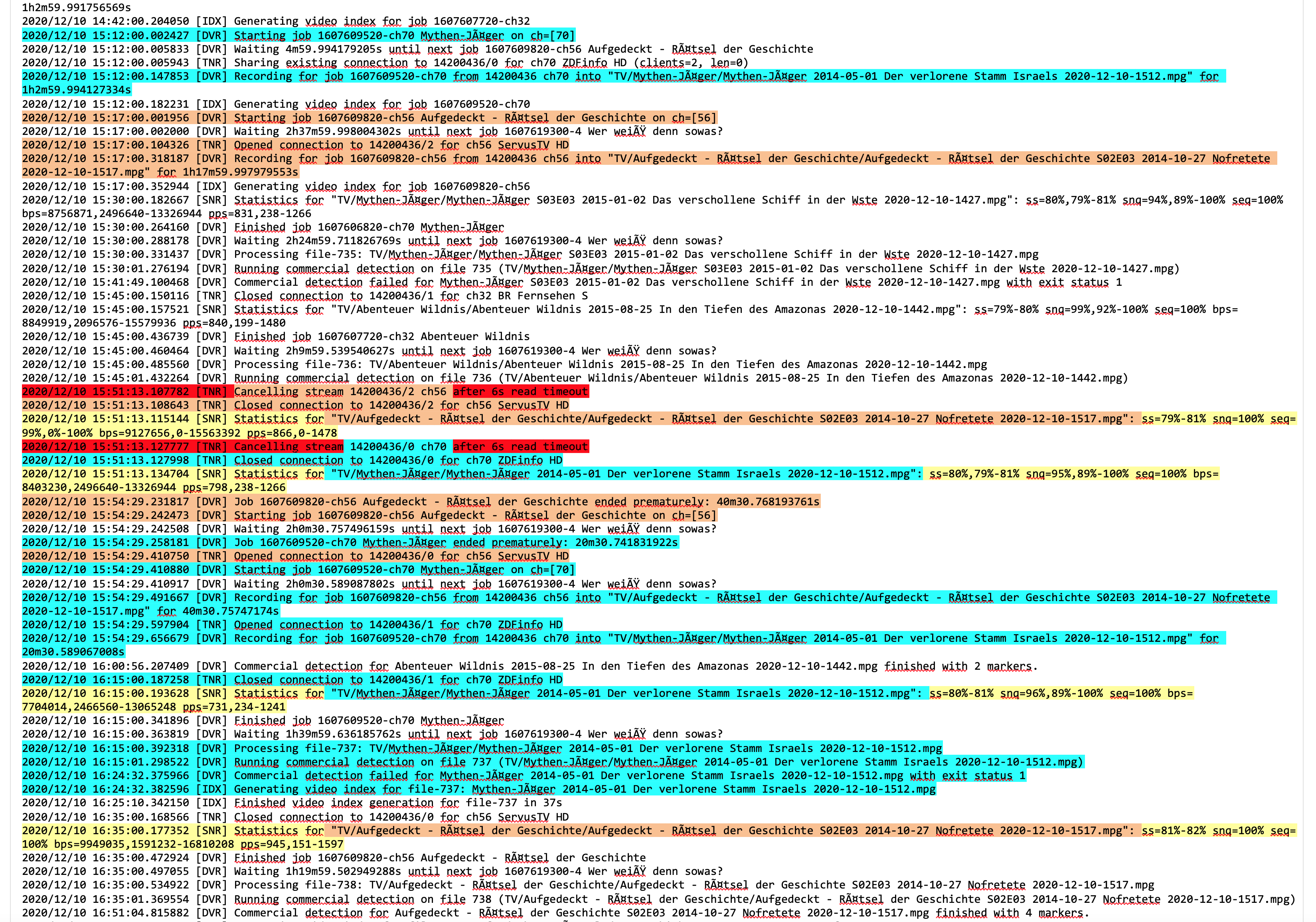

The current Channels-DVR is larger than 173,000 lines and it contains 58 lines with "Canceling stream" and all lines have a 6sec read timeout. For me it's strange that an EMC problem always 6 seconds. lasts.
Can't the interruption be on the channel DVR side?
I have stored the complete HdHomerun and Channels DVR log file on my Goolgedrive.

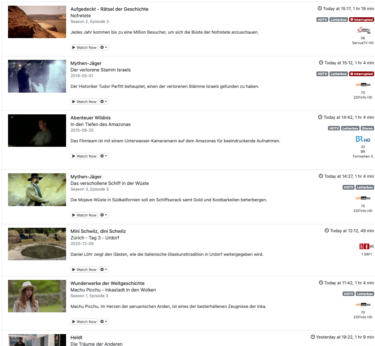

I interrupted recordings at the following stations:
Servus TV (714000 kHz)
ORF 1 (522000 kHz)
ARD (714000 kHz)
Sat 1 (53000 kHz)
BR (802000 kHz)

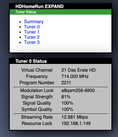

On my.hdhomerun.com under Tuner Status check what the signal strength and quality are shown as while watching or recording.

These are the print screens of the current recordings
HDHomeRun Tuner Status 2020-12-09 19-21-57
HDHomeRun Tuner Status 2020-12-09 19-30-28

This looks good. Signal is 100% (is it amplified?), and pps/bps never hit zero:
If you look at the same lines from your earlier log, the situation is not as good. The pps/bps is dropping to 0, and must be at 0 for 6 seconds before the timeout error would happen.
The HDHomeRun receiver is connected directly to the wall socket with a cable, so no amplifiers are connected.
I have now switched 2 TV splitters in series in between to weaken the signal. Just like racameron recommended it.
The signal strength is now 80%. I will now watch it all.
Thank you
HDHomeRun Tuner Status 2020-12-10 10-55-11
Today I took 5 sample recordings, some of them were even at the same time.
At 3:51 pm there was the interruption again and thus the last 2 recordings were interrupted.
Unfortunately, I don't have the knowledge to interpret the signal strengths in the log file,
In the logfile I have colored the two programs with different colors so that it is easier to read.
Can each read something out there?
What is the network path between the HDHR and the DVR?
2 switches. The switch from the Netgear Orbi and a simple GS Netgear switch.
It is preferred that the dvr and the HDHR be plugged into the same physical switch
Since both tuner 0 and 2 timed out at the same time 2020/12/10 15:51:13 it does appear to be a network or HDHR issue. Or, both of those channels (56 and 70) are on the same frequency.
It's worth emailing [email protected] with your HDHR device ID to see if they can tell anything more from the HDHR diagnostics
You will need to enable the checkbox on my.hdhomerun.com to send them extra diagnostics
I wrote the support from Silicondust. I'm curious if they can help me.
