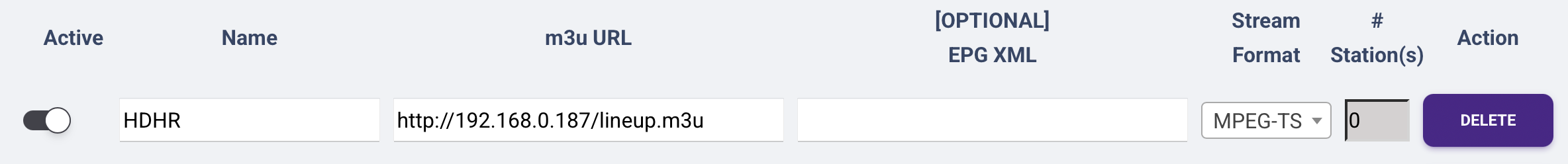

Hi, I'm having trouble adding the m3u link for a HDHR. I can fully access the link myself, and confirmed the link and m3u file are accessible over the network within the docker container, but I get 0 stations. Same outcome using either the full IP or hdhomerun.local.
Just to make sure, have you run Update Station List yet? Because you'll have zero stations until you do. This is essentially the "Import into PLM" function.
