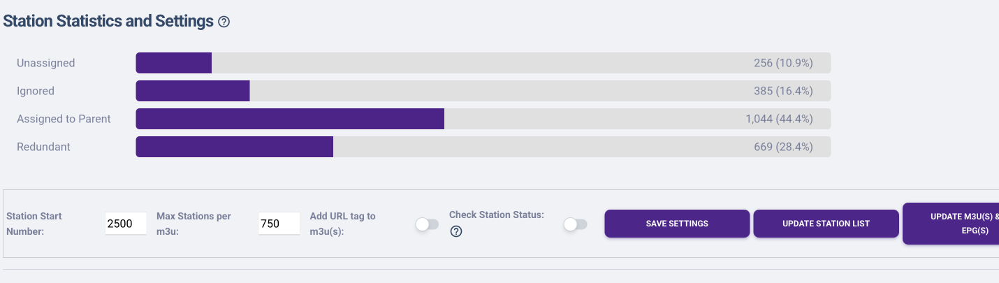

Hi, loving the utility, consolidation and automation that PLM brings to my Channels server. I'm having an issue this morning though, hopefully there's an explanation. I have six FAST providers added to PLM. I hadn't classified new channels as parent/child in a few months, or even gone into PLM's management page, so this morning I started to dive back in to check in on things, and do just that. I saw there were about 250 new "unassigned" channels. All of the other channels were previously categorized. I started to scroll through, categorized one as parent, one as a child, and ignored 5 or 6. Then saved, and scrolled through to ignore 10 more. After a page refresh though, I now see that my "Station Statistics and Settings" reporitng that nearly all of the channels (2,181) are now unassigned, only 141 are assigned and only 32 are ignored. Like, the assignments have been reset? I'm not sure why it would be those numbers reported though. So now I'm wondering what did I do wrong? And what's the best way to restore from a backup so I don't have to re-assign thousands of channels? I checked the wiki, and the "Files" feature but don't see more specifics about what file to restore, and where from. I'm obviously confused and don't want to make anything go worse if I can help it. My docker installation is on an M1 Mac mini. Thanks for any guidance :pray:

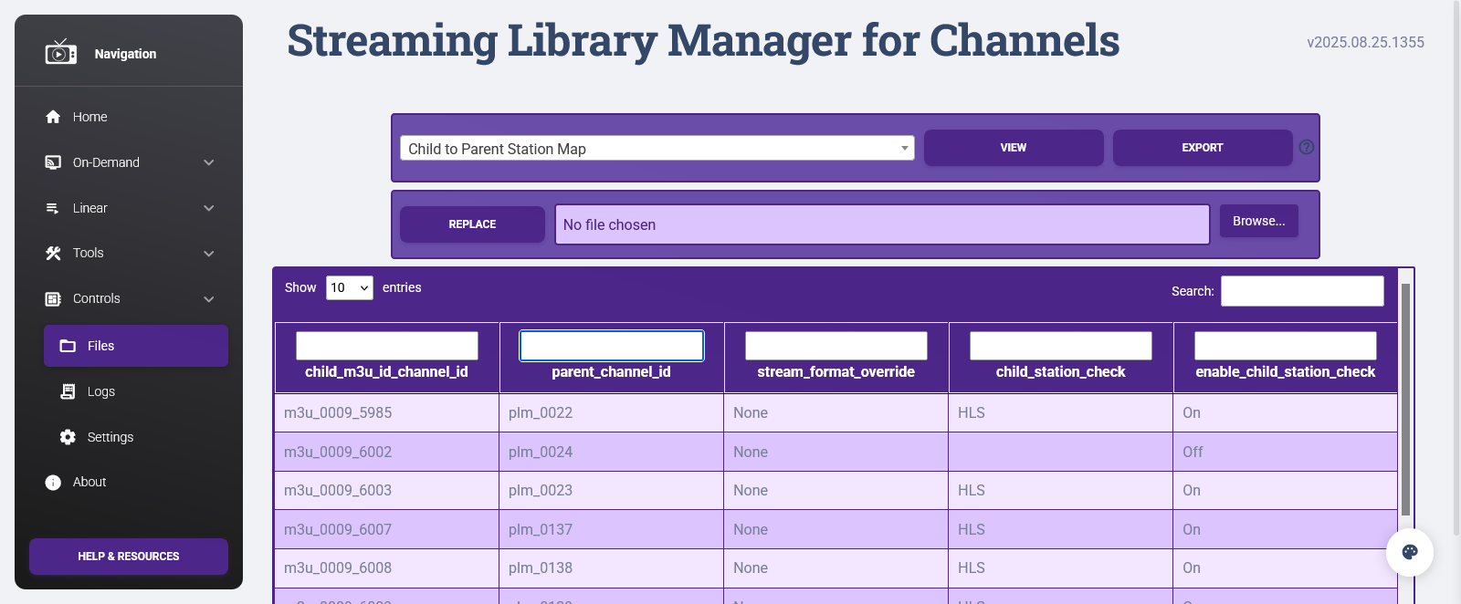

I can't figure it out from what you described because the Unassigned page cannot impact the assigned stations. I could see if you used the Assigned page and clicked the Set Visible button after scrolling through almost everything, but that doesn't sound like what happened.
The file you'll need is PlaylistManager_ChildToParent.csv from the most recent backups directory (probably should be one from whenever your backup ran this morning, assuming you didn't disable this feature). You can either just copy it into the main program_files directory and replace the file that is there, or upload using Files with this selection:
There's no need to stop or reset SLM as part of this; it always just reads the file live.
Phew! Back in business. Thanks.
For anyone else following along, I used Docker Desktop to locate the backup file. And then PLM's "Files" tool to restore it.
