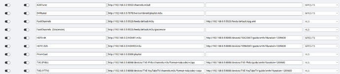

Some more detail on the CBSNEWS PVE issue. I use Philo for a TVE provider in CDVR. There doesn't appear to be an option in the PVE source provider options in CDVR to set it to MPEG-TS or HLS.
I've had it configured as the TVE provider for quite some time now, and this channel previously worked without issue. However, when I went to tune to it yesterday, I received the error: "TVE Error: Detected MPEG-TS instead of HLS playlist" on my TV screen.
I found this thread: Detected MPEG-TS instead of HLS playlist and saw mention of this tool.
So, I:
  1. Spun up a docker container and tried to configure it to get around the issue.
  2. I pulled in the Philo TVE provider m3u into SLM as a playlist with Stream Format "HLS". In the Assigned Stations setting, I set the "Stream Format Override" to "MPEG-TS". I saved that, updated the M3Us and added them to CDVR. I received the same error.
  3. I then went ahead and pulled the m3u as a separate playlist with Stream Format "MPEG-TS". I then removed the Parent Station from the original m3u, and added the new playlists entry for this station as the Parent Station, and left "Stream Format Override" as "None". I again regenerated the m3u, removed the existing entries from CDVR manually, added them again through SLM, and then tuned to the new station number with the same error result.
  4. I then went back into SLM and set the Stream Format Override for the Assigned Station to "MPEG-TS", updated the m3us in SLM and refreshed them in CDVR, and received the same error.
At that point in time, I noted the option to add this as a streaming station, and set up the Streaming Station for the cbsnews.com link.
  1. I configured the streaming station as suggested in the guide.
  2. I removed the SLM providers from CDVR manually.
  3. I set the TVE entry to use the Streaming Station as its parent (to be able to pull in the EPG information).
  4. I overrode the channel number (in SLM under Parent Stations) to match what the Philo TVE entry is being assigned in CDVR
  5. Set the Preferred Playlist to be the PLM - Streaming Stations, then regenerated the m3us from SLM and only added the m3u Playlist - Gracenote (MPEG-TS) [01] (containing 1 station) to CDVR, and it now works.

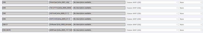

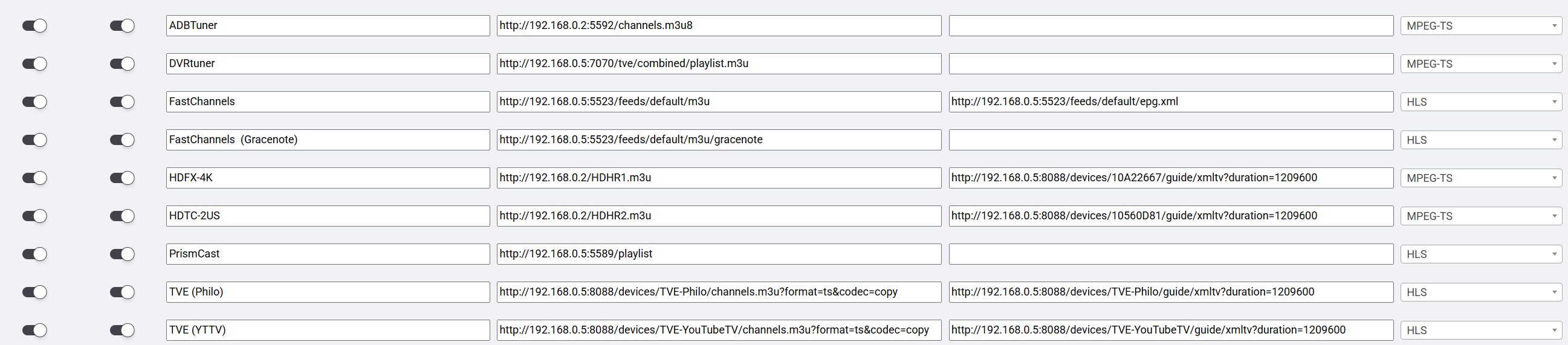

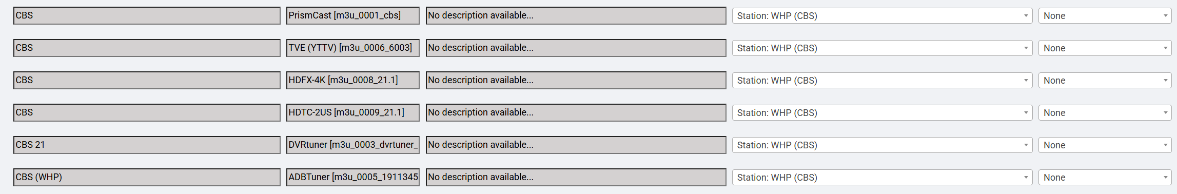

I have multiple sources that are a mix of HLS and MPEG-TS.
As an example, CBS comes in via HLS from PrismCast and TVE, and comes in via MPEG-TS from my HDHR tuners and ADBtuners.
I setup the parent for CBS and put all channels underneath (HLS and MPEG-TS).
However, in the m3us I serve up to Channels, it's only showing CBS under the MPEG-TS feed and not the HLS feed:
My question is, if my HDHR Tuners were having an issue and PLM had to fallback to a HLS source (TVE as an example), how does Channels manage an HLS source coming through the MPEG feed? Just want to make sure I am setting this up correctly to have full redundency.
Thanks,
Jay
If a Parent station's source Child station is now HLS instead of MPEG-TS (or vice versa), it will move from one resulting PLM playlist to another, like with these two:
However, the unique channel_id is still the same, so as far as Channels is concerned, it's still the same station and will maintain everything about it (Channel Collections, Gracenote guide data, attachment to recordings, etc...).
Should you somehow have a HLS station on an MPEG-TS playlist (which can only happen in PLM from intentional misidentification), Channels identifies and handles it. This isn't true of a MPEG-TS station on a HLS playlist. Some recommend making everything MPEG-TS due to this, but I don't. My feeling is that if a difference exists, there may be a benefit, so why not take advantage? Others don't think it matters, but let's not debate this again as this has been done to death elsewhere and I don't want any more spam on this topic in this thread.
That's a personal preference. For OTA and TVE versions, I actually keep both and use source order, favorites, and station numbers in Channels to manage which ones go first:
Most everything else, though, I just have a preference order in PLM and only keep one version. So something like Channels TVE > EplusTV > PrismCast (and a bunch of other stuff, just not complicating it here).

If I am interpreting your response correctly, you have your setup so there isn't 1 CBS Parent Channel that has multiple sources feeding it. You have multiple parent channels setup, "delineating" them based on the source type and use a separate channel (12.1 for MPEG, 8200 for HLS)? Thus in CDVR you have 2 entries and then use favorite or source preference in the channels source (since MPEG-TS has a separate M3U than HLS)?
What I was looking to do was to have 1 "physical" channel per actual channel in the guide in CDVR that was fed by PLM. In the event that primary channel fails for any reason the backup channel would be picked up inside the single "physical" channel (usually OTA -> TVE -> PrismCast -> FAST -> ADBtuner) and not have to fall back to another channel in my guide.
Can I setup 2 Parent Channels (CBS - HLS; CBS - MPEG) and map the aprropriate streams to each and then have them both use the same channel number? Not sure how Channels will react to that, I'll start playing around now as I've only setup about 20 of the 200 I usually setup and would like to make sure I don't have to do any re-work after setting it up.

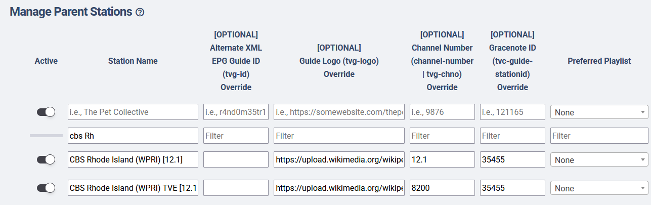

Not quite; I have 2 CBS Parent Stations. One is for my HDHR, the other one is for every other source (Channels TVE, PrismCast, etc...). This has nothing to do with HLS and MPEG-TS or any technical reason; it's just to have a safety backup version in Channels should my preferred one (OTA) go down.

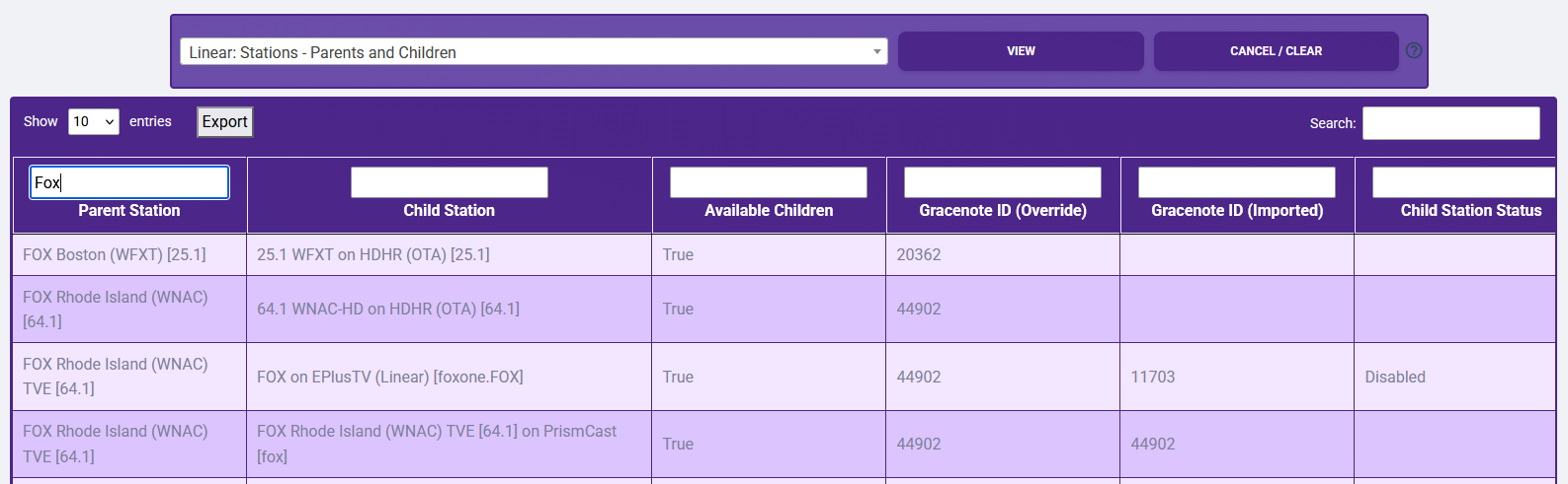

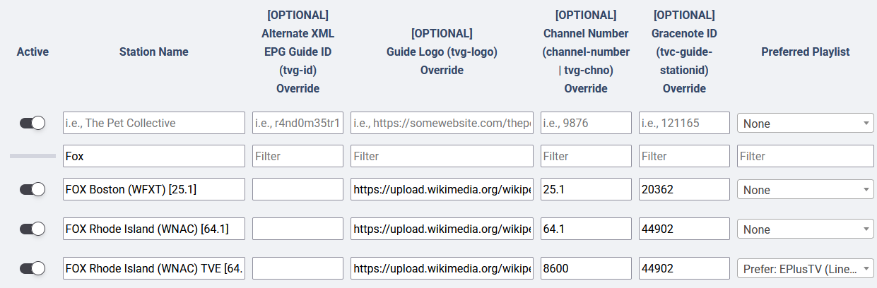

Let's look at another example. I do the same thing with my local Fox:
First, the parents are filled in PLM based on PLM preference order and current status:
So, by PLM logic, I end up with the local OTA Market 1, local OTA Market 2, and Local TVE Market 2 versions of the station. In this example, you can also see that since the EPlusTV feed has a status of "Disabled", PLM has moved on to the next priority. Thus, my Local TVE Market 2 is using PrismCast instead.
After that, I end up with only the three Fox stations in Channels. Based upon my Channels DVR priority order of sources and favorites, the OTA stations come up first (with an order between them of which market I prefer), then the TVE one:
In other words, Channels DVR handles Providence OTA > Boston OTA > Providence TVE. Within Providence TVE, PLM determines which SINGULAR one I get, with EplusTV > PrismCast.
And again, I only do this for personal preference; no one has to do what I did. I could just as easily had one "Fox Local" and let PLM handle everything and call it a day.

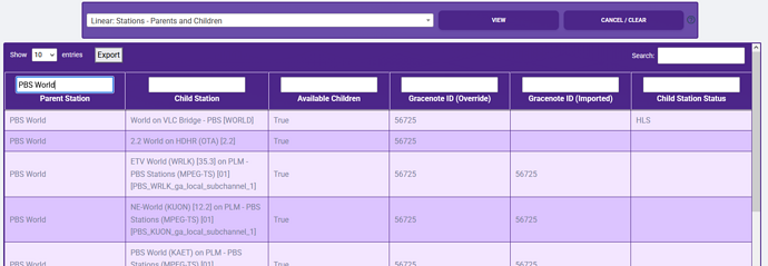

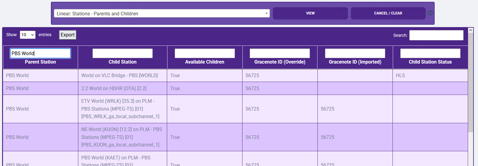

Here's another example to look at with "PBS World":
I have 75 children assigned to the singular parent. Based upon source priority order, VLC Bridge PBS > HDHR OTA > PLM Internal PBS Playlist. VLC Bridge PBS is set as MPEG-TS; however a station check reveals that PBS World is actually HLS. Thus, the parent station is assigned to my PLM HLS Gracenote playlist. If during the check station status routine the VLC Bridge PBS came back as "Disabled" for any reason, then the next time the PLM m3u's are built, PBS World will go to the next priority, which is the HDHR OTA one. Since I don't check the station status for that source, it has a status of "null", and thus will be chosen no matter what. Also, since this my HDHR OTA source, it is MPEG-TS. As such, PBS World moves from PLM HLS Gracenote to PLM MPEG-TS Gracenote.
But it does not matter because the channel-id is unique to the Parent and is the same no matter the playlist:
Further, this means as far as Channels DVR is concerned, this is the same station, just being provided by a different "Custom Channel". The next time the m3u's are updated in Channels DVR, all of this will be seamlessly reflected. And, of course, you shouldn't need to do anything because this can all be handled by automation.
