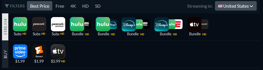

i’m not sure if this is related to the software version I’m on which is v2026.06.25.1156 but I just noticed that two shows which went off of their streaming services did not get updated stream link files despite being on other services I have included in my provider list. For example, I had lNew Girl bookmaried, and had been watching this through Hulu. it appears this is no longer available on Hulu, but is available on Amazon prime which I also have in my provider list however, the stream link files continued to point to Hulu. I’ve examined the show and it shows available on Amazon prime and not Hulu. I’ve even had slm regenerate the stream link files and I’ve also moved Amazon Prime above Hulu in my provider list, but none of these seem to have fixed the issue. I suppose I could just set the preference to be Amazon prime for the show but if this is an issue, I wanted to bring it to your attention. I apologize if this is instead of user issue.
Jim
oh, and although I did not explicitly say so I’ve rerun the automated task Stream Link/File Manage both manually and as part of its daily scheduled run several times.
Per the Troubleshooting & FAQ section on the Wiki, this is because of the source data from JustWatch. If you go to their website and search for the program, you can see that in the Stream (aka subscription) options, Hulu is listed, but Amazon Prime is not:
Notably, even though in SLM and here you see the "Prime Video" icon, it is not available on the provider "Amazon Prime Video". This program is available on Amazon for purchase, so that would be the provider "Amazon Video" if you did that.
SLM is completely dependent upon JustWatch having correct data. If you find an issue like this, just follow the directions in the link above to submit the issue to them. Potentially, while waiting for a fix, you could manually override the Stream Links, but I'm sure you'd rather not for something with so many episodes.
However, I did just check, and New Girl is on Hulu/Disney+. I'm wondering if there was a slight gap for some licensing reasoning or the other. If you are using an Android TV device, I have found Hulu has killed the ability to accept deep links, so if you click to launch it, nothing happens (a different error also discussed on the Troubleshooting & FAQ wiki page). You pretty much have to do the Hulu to Disney+ conversion now to get it to work there.
Thank you so much! I never caught the “Stream” vs “Buy” next to the rows of icons on JustWatch. I will also use the link when I find inaccuracies. Again thanks for the great app and support!
