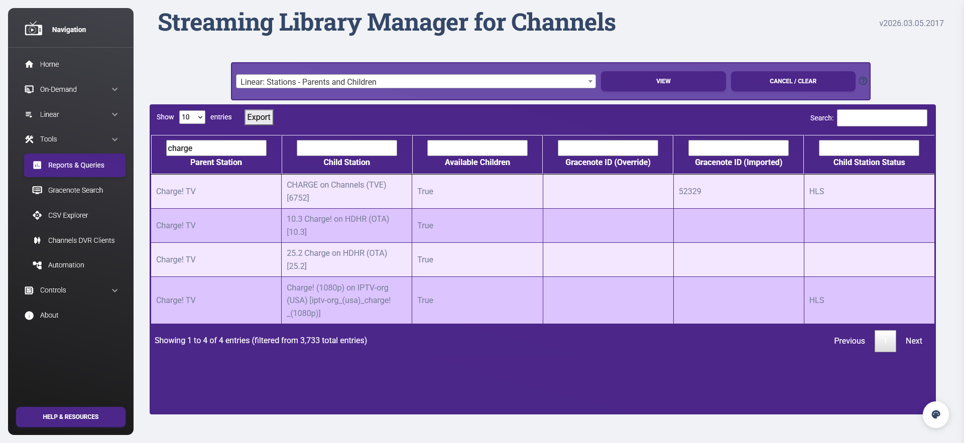

If you run the report Linear: Stations - Parents and Children you can see the assignment order as PLM would do it and if there are any issues with each source:
As you can see, I have practically the exact same situation as you and do not have that issue; the TVE one plays as expected.

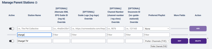

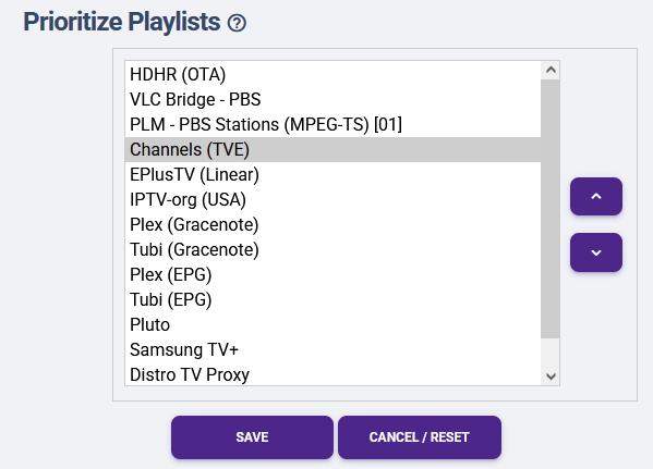

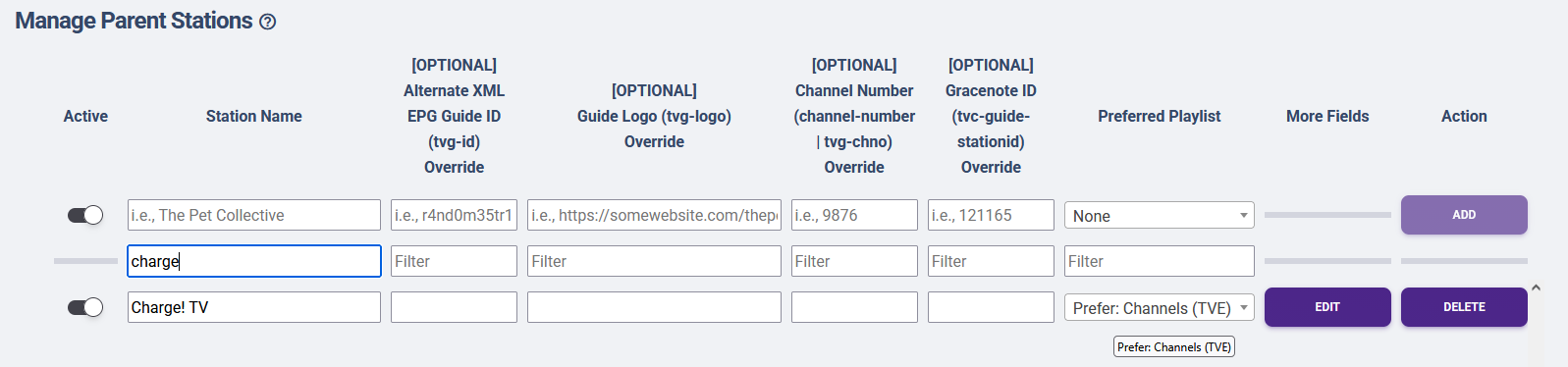

  1. Make sure TVE has a higher source priority...
    ... and/or set TVE as your Preferred Playlist at the parent.

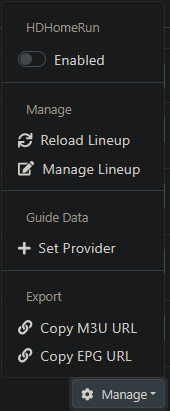

  2. Confirm HDHR is disabled in Channels:
On the disabling hdhr - i set it up and use the link to send to slm right? and disabled allows the m3u to keep working?

Here's another example to look at with "PBS World":
I have 75 children assigned to the singular parent. Based upon source priority order, VLC Bridge PBS > HDHR OTA > PLM Internal PBS Playlist. VLC Bridge PBS is set as MPEG-TS; however a station check reveals that PBS World is actually HLS. Thus, the parent station is assigned to my PLM HLS Gracenote playlist. If during the check station status routine the VLC Bridge PBS came back as "Disabled" for any reason, then the next time the PLM m3u's are built, PBS World will go to the next priority, which is the HDHR OTA one. Since I don't check the station status for that source, it has a status of "null", and thus will be chosen no matter what. Also, since this my HDHR OTA source, it is MPEG-TS. As such, PBS World moves from PLM HLS Gracenote to PLM MPEG-TS Gracenote.
But it does not matter because the channel-id is unique to the Parent and is the same no matter the playlist:
Further, this means as far as Channels DVR is concerned, this is the same station, just being provided by a different "Custom Channel". The next time the m3u's are updated in Channels DVR, all of this will be seamlessly reflected. And, of course, you shouldn't need to do anything because this can all be handled by automation.
