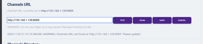

Ok, so finally got most everything figured out between figuring out how to install and use Olivetin (what a freaking life saver that is!) and with the help of @bnhf, I have the dvr setup correctly and now slm can easily use the correct folders for the streamlink files.
Now, a new odd issue popped up that I haven't had before. For some reason, slm won't use the channels dvr URL anymore. It was using it fine earlier today when I would test it but it suddenly isn't working.
Here is a screenshot from slm web UI:
That is the correct URL for my server and was working earlier at that same address as I mentioned above.
Anything else I can provide that may help you tell me what I am doing wrong?
See if the Docker internal gateway works for you, which should be 172.17.0.1:8089
Unfortunately that didn't work either.
Could you post a screenshot of your Portainer-Networks page? It should look something like this:
@jasonmcroy I had issues with the address too and this is what worked for me:
Yes! That's what worked for me.I tried all other suggestions, including the actual IP address of the server, and nothing worked. Thank you. Will do, thanks.
host.docker.internal is primarily a WIndows thing, and is the hostname version of the IP address I'm trying to figure out for @jasonmcroy. Not to say it couldn't be set in a specialized environment like Unraid, but it's not typical.
Unfortunately that didn't work for me.
Ah OK, thank you for the clarification.
I can't find a network tab anywhere.
You need to click on the local environment first, and then you'll see the Networks option.
I am so new at this!
No worries. 172.17.0.1:8089 should have worked as that's the gateway address of your bridge network. I'd try restarting the slm container first, and then try the actual IP address in slm settings, followed by the internal gateway address. Something is not working as it should here...
EDIT: You may want to change your Channels DVR container to use host networking so that it's discoverable on your network by CDVR clients, don't you? If so, let me know, and I'll walk you through that change.
EDIT2: Does your Unraid server have Intel Quick Sync (i.e. a modern Intel GPU)? If so, we should enable that too.
I restarted the container and that didn't change anything. Still not working. Not too big of a deal right now as it only affects being able to update channels from within the slm UI. I just just update from the channel dvr UI.
If you look at your SLM stack, do you have the path set correctly based on the changes we made to your Channels DVR container? Specifically your CHANNELS_FOLDER value? You'd want that set to /mnt/user/dvr or /mnt/user/whatever based on the directory name you used for your CDVR data.
