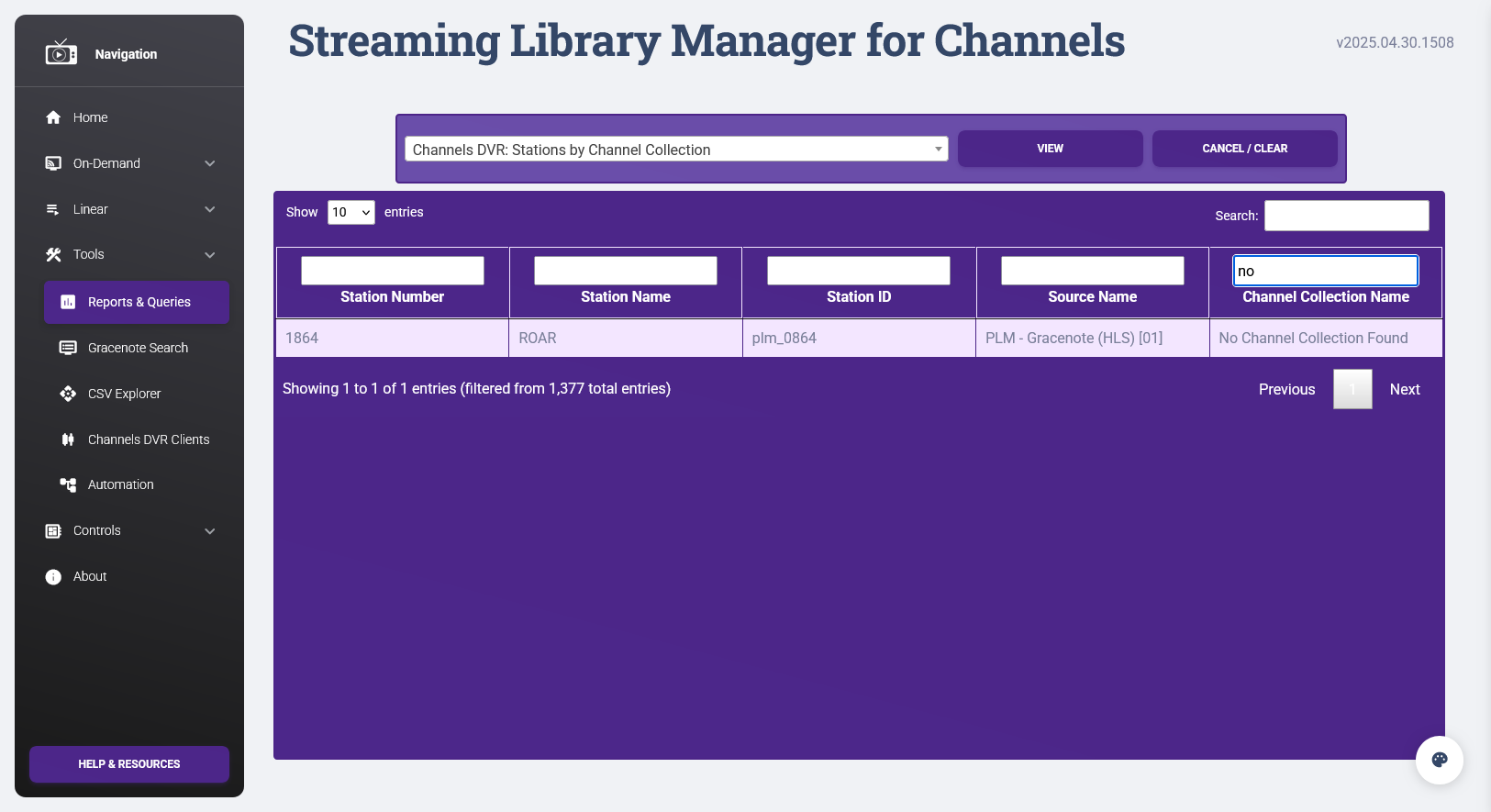

Ah, I see, you are talking about in Channels. By default, Channels shows in order by station number. So you can either (a) manually change the station numbers in PLM to get the order you want or (b) [much easier] use a Channels Collection:
You can just add all from each source...
... and then sort alphabetically.
Just remember when you get new stations to also add them to the collection. You can also always check by running the report/query Channels DVR: Stations by Channel Collection and filtering for ones with "No Channel Collection Found":

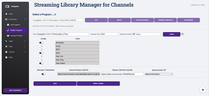

Is anybody else getting 500 errors when adding labels to shows/movies?
@babsonnexus pls assist
logs
    Args: ImmutableMultiDict([])
    Data: No data
    Form Data: ImmutableMultiDict([('title', 'Evangelion: 3.0+1.0 Thrice Upon a Time (2021) | MOVIE'), ('entry_id', 'tm323222'), ('field_title', 'Evangelion: 3.0+1.0 Thrice Upon a Time'), ('field_release_year', '2021'), ('field_bookmark_action', 'None'), ('webpage_label_id_1', 'slmlbl_0003'), ('webpage_label_name_1', 'Action and Adventure'), ('webpage_label_id_2', 'slmlbl_0001'), ('webpage_label_active_2', 'on'), ('webpage_label_name_2', 'Anime'), ('webpage_label_id_3', 'slmlbl_0005'), ('webpage_label_name_3', 'Cartoons'), ('webpage_label_id_4', 'slmlbl_0004'), ('webpage_label_name_4', 'Game Shows'), ('webpage_label_id_5', 'slmlbl_0002'), ('webpage_label_name_5', 'Sports'), ('webpage_label_id_6', 'slmlbl_0006'), ('webpage_label_name_6', 'Westerns'), ('field_object_type', 'MOVIE'), ('field_status_1', 'on'), ('field_stream_link_override_1', ''), ('field_special_action_1', 'None'), ('action', 'program_modify_save')])

It seems to error out when I try adding a custom stream link too. Bizarre
I can't seem to replicate, everything is working for me:
Is there something else in the logs from before there, like something that mentions a specific line of code?
Or could Tailscale be pointing somewhere wrong? What happens if you just use localhost or the ip address directly? Or are you using this remotely (haven't really done too much remote testing)?

It is. Basically, I figured out that if you try to import metadata (and particularly labels) from Channels and you don't have any (or any valid ones), it can corrupt certain data files, resulting in the errors you were seeing. This is now fixed so it won't happen again, but you might have to do a quick manual fix to reverse the damage. Details here:
I'm not getting anything like that in a new installation, but I'm not sure if something was moving too fast for you. That could happen if the Settings file doesn't exist. Even if the thread does start before the file exists for some reason, it will correct itself anyway once the file is created (it's constantly checking).
This is your issue; as the warning says, Apple TV clients are not supported at this time. It's up to the Channels Devs to fix something related to ffmpeg in there, which I know they are hesitant to do because it could impact a lot of other functions. Sorry, there is nothing more I can do to work around it; I beat my head against a wall for weeks trying to find a way.

Still not working. Although, this time everything else works but setting the label :rofl:
[ERROR | 2025-05-15 22:47:21,108] - Exception on /modifyprograms [POST]
  File "/usr/local/lib/python3.12/site-packages/flask/app.py", line 1511, in wsgi_app
    response = self.full_dispatch_request()
  File "/usr/local/lib/python3.12/site-packages/flask/app.py", line 919, in full_dispatch_request
    rv = self.handle_user_exception(e)
  File "/usr/local/lib/python3.12/site-packages/flask/app.py", line 917, in full_dispatch_request
    rv = self.dispatch_request()
  File "/usr/local/lib/python3.12/site-packages/flask/app.py", line 902, in dispatch_request
    return self.ensure_sync(self.view_functions[rule.endpoint])(**view_args)  # type: ignore[no-any-return]
  File "/app/slm.py", line 2284, in webpage_modify_programs
    temp_record = create_temp_record(label_maps[0].keys())
IndexError: list index out of range
2025-05-15 22:47:21.113010:  ERROR: Webpage responded... 500 INTERNAL SERVER ERROR
Did you do the manual fix to get the headers back into the label files as shown in the link above?
Yep...and each file has their header rows so yeah :man_shrugging:
Okay, I got it now (for real this time!):
Finally. It works!! :smiley:

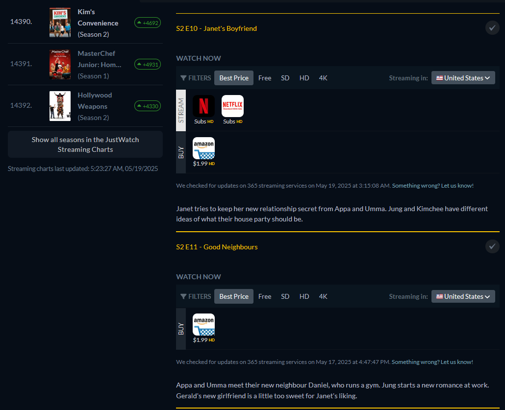

SLM deleting episodes it should not. The issue started with v2025.05.16.1232
The first delete in the log is correct. It then goes on to delete episode 11 for other shows even though they exist. See this log info:
2025-05-19 06:15:00.723152: Beginning SLM New & Recent Releases process...
2025-05-19 06:11:03.022976: SLM End-to-end update process complete.
2025-05-19 06:11:03.022976: Total Elapsed Time: 0 hours | 1 minutes | 2 seconds
2025-05-19 06:11:01.022277: Connecting SLM and Channels DVR metadata complete.
2025-05-19 06:11:00.864003: Scan complete.
Deleted: \BEE\dvr\DVR\Imports\TV\slm\Kim's Convenience (2016)\Season 05\S05E11.strmlnk
Deleted: \BEE\dvr\DVR\Imports\TV\slm\Kim's Convenience (2016)\Season 04\S04E11.strmlnk
Deleted: \BEE\dvr\DVR\Imports\TV\slm\Kim's Convenience (2016)\Season 03\S03E11.strmlnk
Deleted: \BEE\dvr\DVR\Imports\TV\slm\Kim's Convenience (2016)\Season 02\S02E11.strmlnk
Deleted: \BEE\dvr\DVR\Imports\TV\slm\Kim's Convenience (2016)\Season 01\S01E11.strmlnk
Deleted: \BEE\dvr\DVR\Imports\TV\slm\The Good Place (2016)\Season 04\S04E11.strmlnk
Deleted: \BEE\dvr\DVR\Imports\TV\slm\The Good Place (2016)\Season 03\S03E11.strmlnk
Deleted: \BEE\dvr\DVR\Imports\TV\slm\The Good Place (2016)\Season 02\S02E11.strmlnk
Deleted: \BEE\dvr\DVR\Imports\TV\slm\Brooklyn Nine-Nine (2013)\Season 06\S06E11.strmlnk
Deleted: \BEE\dvr\DVR\Imports\TV\slm\Brooklyn Nine-Nine (2013)\Season 05\S05E11.strmlnk
Deleted: \BEE\dvr\DVR\Imports\TV\slm\Brooklyn Nine-Nine (2013)\Season 04\S04E11.strmlnk
Deleted: \BEE\dvr\DVR\Imports\TV\slm\Brooklyn Nine-Nine (2013)\Season 03\S03E11.strmlnk
2025-05-19 06:10:00.153985: Beginning SLM end-to-end update process...
Thank you for looking into this
This is not an SLM issue; SLM is working exactly as expected. The problem lies with the metadata on JustWatch, on which SLM is dependent. If you follow the Troubleshooting / FAQ directions, you would see that those episodes are missing links to your streaming services. For instance:
Given the very specific pattern of episode 11 on Netflix, I'm fairly confident this is a temporary issue and they'll have it fixed by tomorrow. But if not, follow the directions from the link above to let them know.
