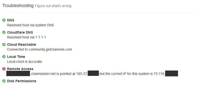

1. Remote access is not working, see screenshot. It says that channelsdvr.net is pointed to the 193.37.xx.xx IP address but the current IP for this system is 73.119.xx.xx, the 73.119 is correct, I cannot figure out where the 193.37.xx.xx IP is coming from or how to correct it. Amplifi Alien router basically running all defaults with port forwarding rule added for channels. Had same issue with older Nighthawk router.

  1. In regards to the IP issue: have you tried toggling the "Remote DVR" option off/on? This may help to kick off a a resync of the IP address.

What IP does ipchicken.com show?
Are you using a VPN?
I am using a VPN on my current PC (work system that I happen to be using at the moment), but I do not have a router/NAS level VPN enabled. The issue is the same on my Mac without VPN. IPChicken shows the correct 73.119 IP.
  1. Well, I feel dumb - "Just turn it off and on again" worked. I had only previously switch between automated and manual configuration. so.... THANKS!
