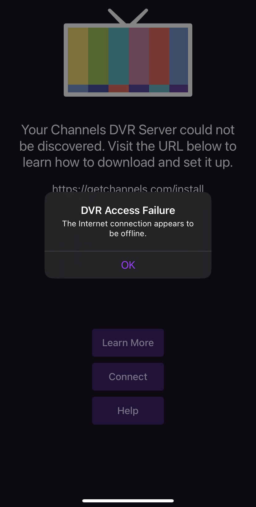

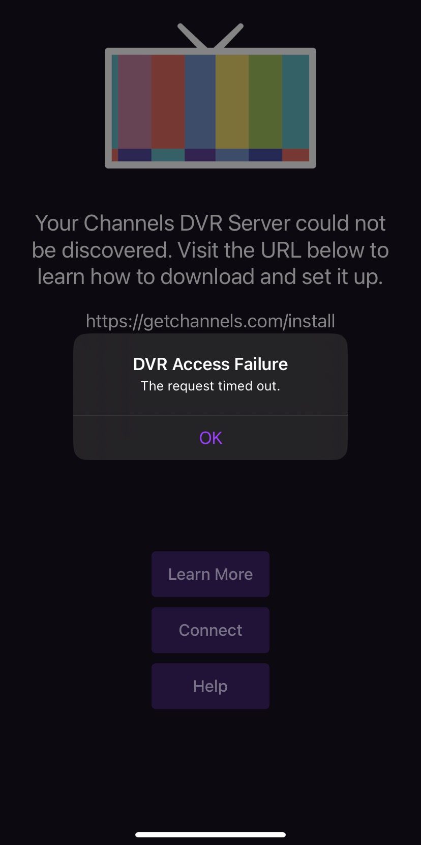

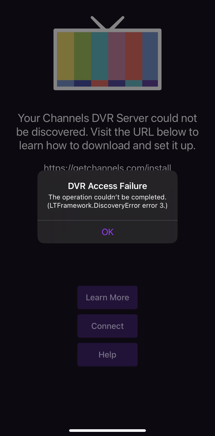

I have been having issues accessing my server remotely for several weeks now. I’m running on an Nvidia Shield and made sure to update all apps and devices. I have 8089 set as the port and cannot even access it via my.channelsdvr.net, let alone through the app. Should I delete the server and reinstall? And it seems every time I try to connect and choose “Away From Home”, I get a different error (see pics) or it does not show anything on the guide, even though I know my HDHomeRun is plugged in and connected.
Both HDHR and Shield are hardwired.
