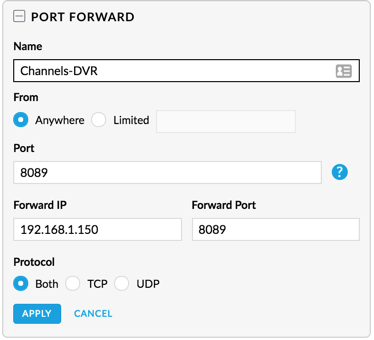

I have a Unifi USG router, and Channels DVR server (running on a mac) and Channels seems to be the only port forwarding that does not work. I have looked at http://192.168.1.150:8089/nat and I get
{"enabled":true,"error":"Failed to discover router.","host":"","kind":""}
I have checked my settings -
Can anyone suggest what I am doing wrong? Thanks
Once you setup the port forwarding rule manually, you can simply uncheck the remote access box.
I also have the USG, a 4 to be exact. And, your rule appears correct to me.
The USG doesn’t yet support configuration of UPNP via the guy so as @tmm1 suggested you can uncheck the remote access box after enabling your rule.
