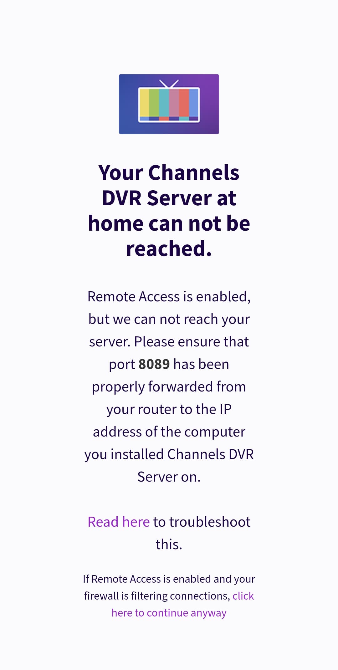

I went out of town over the weekend & couldn't access Channels on either of my devices. I got the following error message:
Once home, I ran the Troubleshoot Tab and got the following result: "Could not connect to 65730332aa2a.u.channelsdvr.net. Check if the port is mapped"

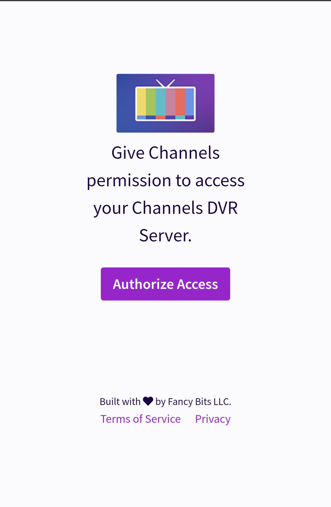

You should see a screen like this if everythjng is open end to end
Yes I see it

That's the standard message, it's ok. If you can see the message that matches my screenshot you are configured fine as far as networking goes. It might be on the channels side of things. Try it again with the channels app over cellular. I think toggling port forwarding in the webui causes a new cert to be generated. If it still doesn't work then @tmm1 might have to have a look on his end.
Edit, make absolute sure you see the msg in my screenshot outside of your network. Make sure wifi is turned off and you are not connecting to the 192 address

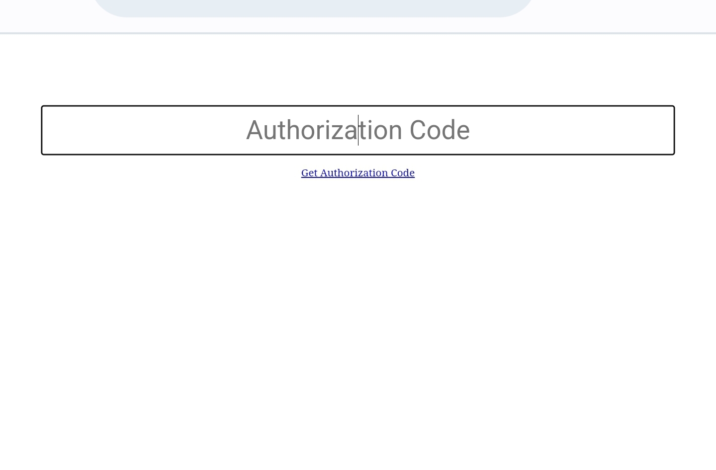

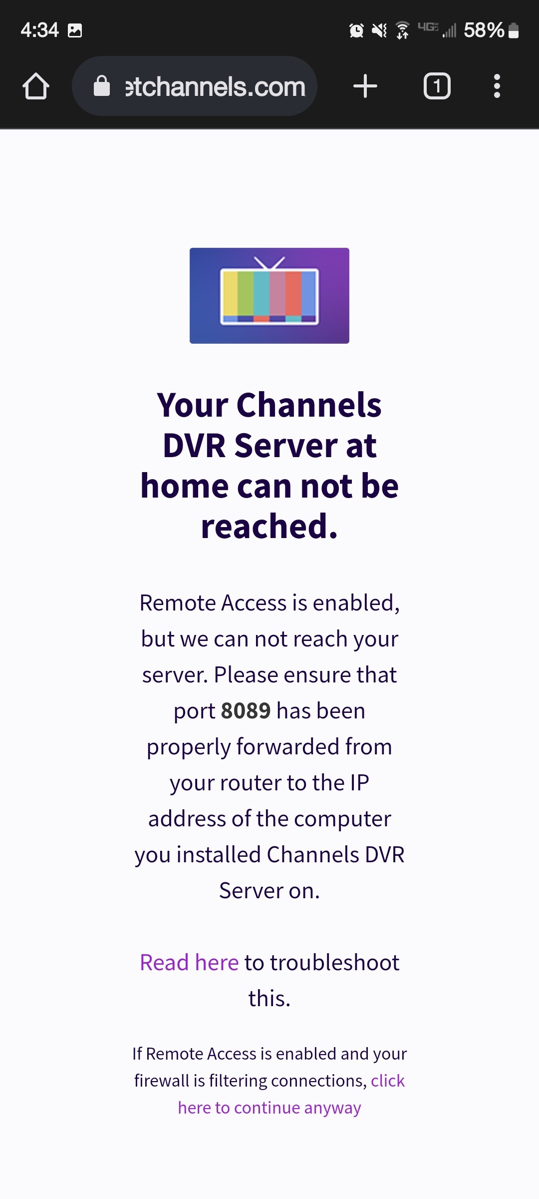

I'm still not able to get the port forwarding issue resolved. I've tested the port using mypublicip:8089 & got the "Authorization Code" screen. But I'm still getting this error message when trying to connect to away from home:
Did you try clicking the "continue anyway" at the bottom?
I have. I'm still getting these error messages:
do the last 2 octets of your public IP address end in 89.5? If not it may be a DNS issue. I did an nslookup on your hostname from the screenshot and I cannot reach your server but it could be because you have enabled tail scale.
