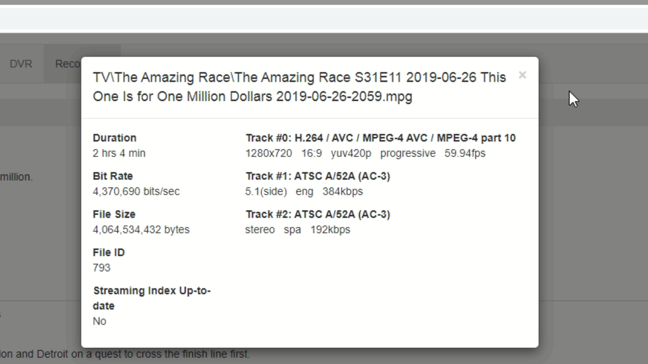

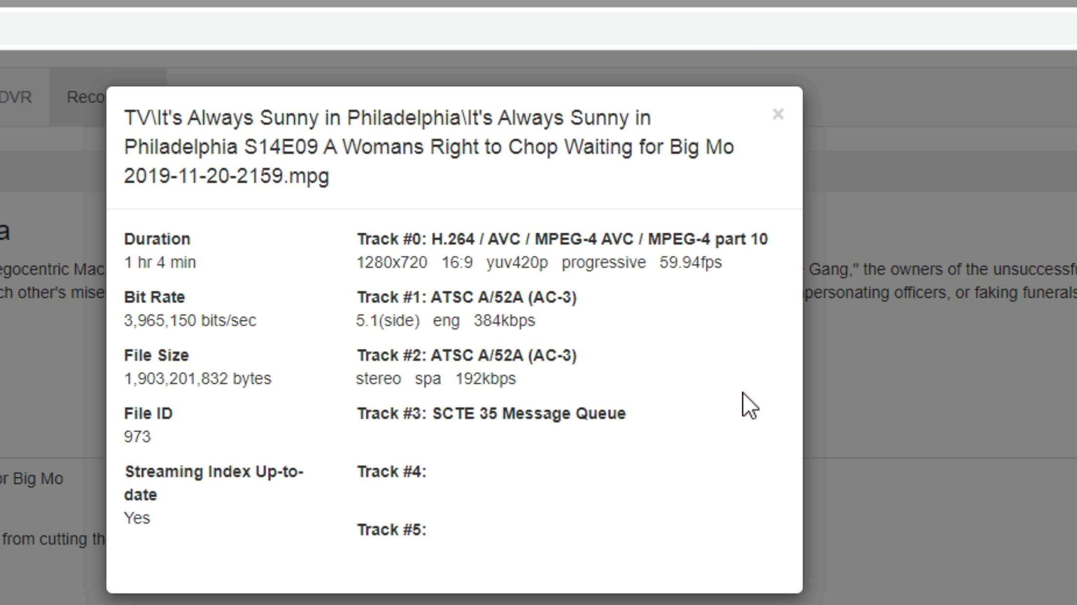

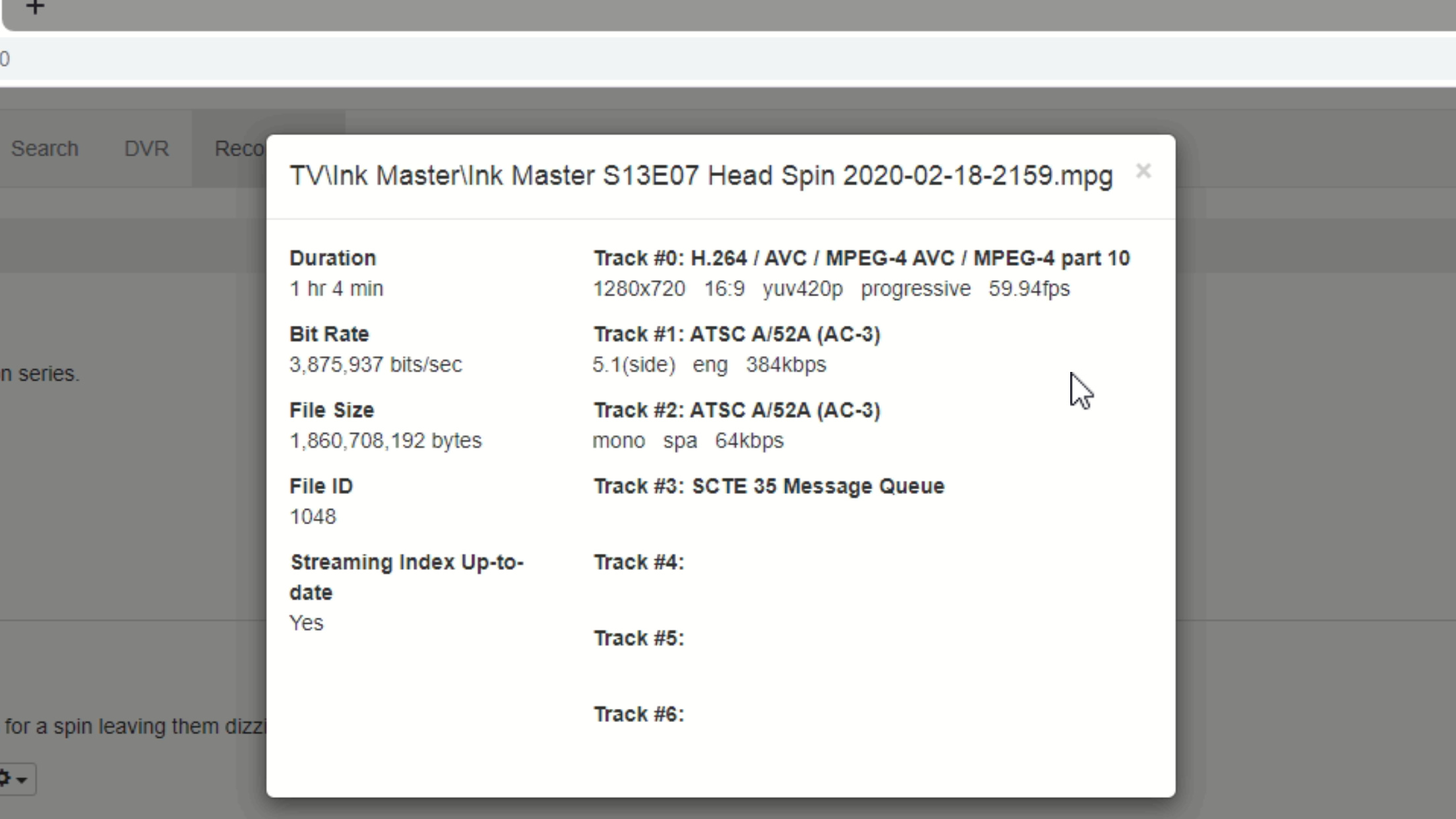

Can you take a screenshot of the View Details of the shows you are taking about here so I can get a better handle on what exactly is going on? There have been some differences and improvements to how we detect the bitrates of the recordings to reduce the need to transcode. There may be bugs in how we handle it that only show up in very specific situations that we’ll need to fix.
Ink Master and It’s Always Sunny both transcode at 4mbps in the web player and Amazing Race transcodes at 10 mbps in the web player. All now transcode with cellular streaming maxed out at 4 mbps where as before Ink Master and Sunny would stream directly at the 4 mbps cellular setting. Amazing Race always transcoded.
If you look at the bitrates for the Ink Master and It's Always Sunny …, you'll see that their bitrate is under 4Mbps (4,000,000 bits per second). Because the files' bitrates are less than the requested maximum, Channels will merely remux the TS container to an HLS stream for compatibility. The Amazing Race bitrate, however, is greater than 4Mbps, and therefore it transcodes instead of merely being remuxed.
