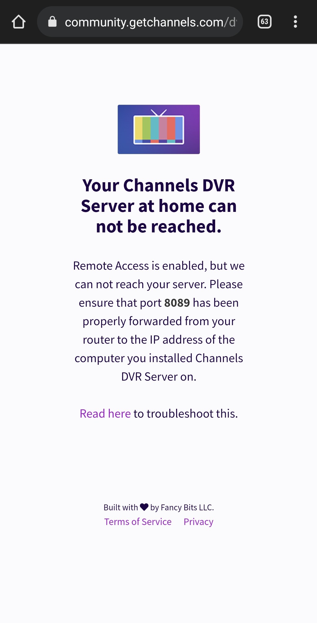

Recently when I try to connect remotely it is not working. I did submit a diagnostic log this evening. It connects fine through the web browser remotely but not via android or ios app. If I can get it to connect and I close the app it wants to re-authenticate again.
When it authenticates I either seem to get the error that channels dvr server at home cannot be reached and then if I refresh I can get into the app. When I get in either recordings are not showing up, or the guide and tv tuners or both. I do not seem to have full access. The correct port is opened and confirmed by portchecker.co inside my network and remotely. When I run troubleshooting every fifth time or so it will say no remote access which seems to be weird. I tried uninstalling and reinstalling from scratch which did not help. Is there possibly an error on the channels server side?
I am attaching a screenshot of one of the errors:

Seems to be some sort of network connectivity issue?
10-22 13:06:22.600  7129  7129 V DVRClient: Jobs error: io.ktor.network.sockets.ConnectTimeoutException: Connect timeout has expired [url=https://x.u.channelsdvr.net:8089/dvr/jobs, connect_timeout=5000 ms]
10-22 13:06:22.601  7129  7129 V DVRClient: Files error: io.ktor.network.sockets.ConnectTimeoutException: Connect timeout has expired [url=https://x.u.channelsdvr.net:8089/dvr/files?raw=false, connect_timeout=5000 ms]
That would seem to explain the issue certainly. Now the question becomes any idea how to solve it?
