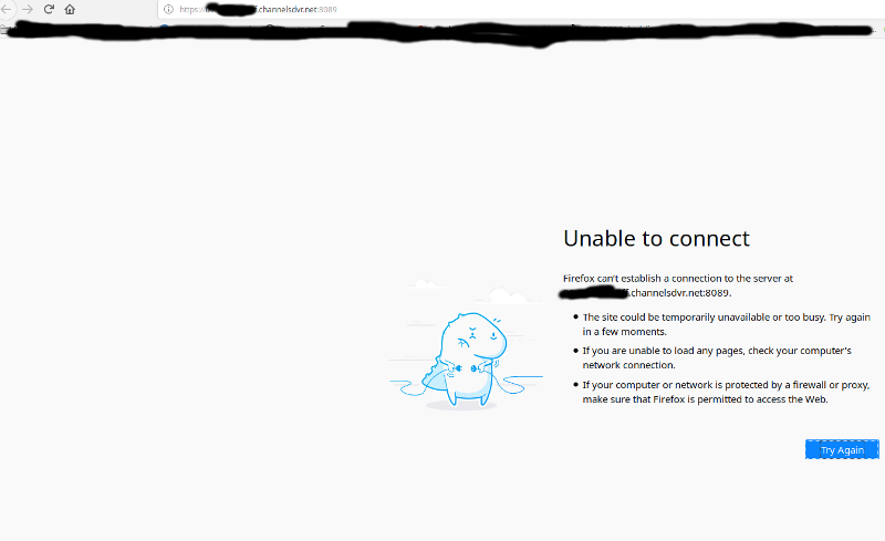

What does my.channelsdvr.net show?
I've attached a screenshotdvr
Are you trying it from your home network or over LTE? Some home routers don't allow connecting back over the public IP.
I'm trying it locally over my home network.
If what you're trying to do is connect remotely to something on your home network from your home network, your router may be prohibiting it. To be able to do that requires the router support, possibly have configured, a feature known as "hairpin NAT." Some routers need that explicitly configured. Some don't support it reliably, or at all.
