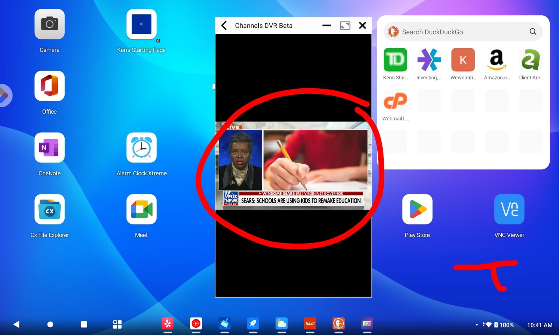

This came very close to working. Using your suggestion, I did get it to play on the tablet while the remote was working, but it only displays in a small window, kind of looking like it is a cell phone emulator running on the tablet. All attempts to make it full screen failed.
Yes, mine was on. I turned it off and the prompt went away, but as soon as the remote connects, the display becomes an image like a cell phone held vertically with a tiny image in the center. The remote does work in this mode, but the image is not usable.

Problem Solved!
The solution came from Jared Newman author of Cord Cutter Weekly and Aadvisorator newsletters.
Jarad Wrote:
"Ahah. It looks like they offer a "Productivity Mode" that automatically
activates when a keyboard is detected; the system probably thinks the
remote is a keyboard.
Try heading to Settings > Productivity Mode and then turning all the
switches off."
I turned Productivity Mode off and everything works as expected.
