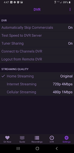

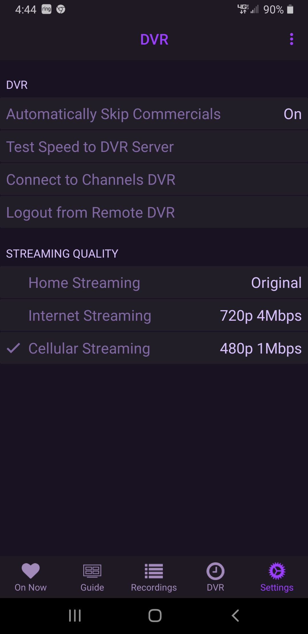

One thing I do notice When I startup the Android Channels app on my phone 4G the tuner sharing option is not there. When I start it on WFI the tuners sharing option is there.
Cellular connections are always remote connections. Remote connections are always using tuner sharing, so the option isn't there.
