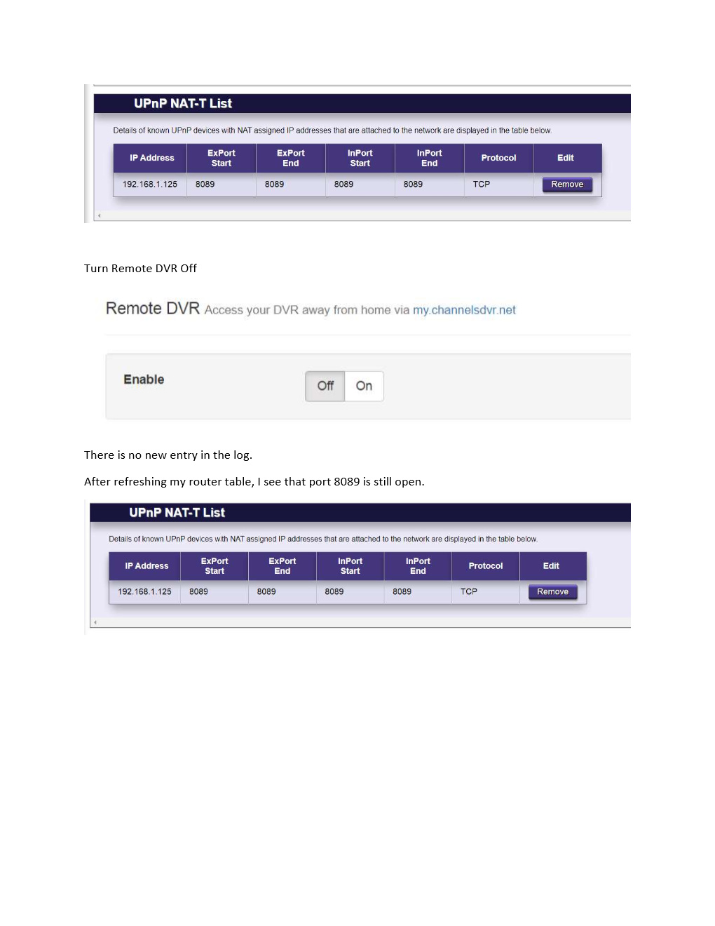

I don't know if this is a feature request or a bug report, but when I enable remove DVR, port 8089 is opened via upnp on my router. When when I turn off remote DVR, the port is not removed. My expectation would be that the port rule would be removed. It's possible that another app needs port 8089, so perhaps you could ask "Do you want to remove upnp port 8089?" and let the user decide, in the same way you do with the choice to automatically or manually add the rule.

Yes, I can reproduce this. I'm uploading images based on my notes. Hopefully these appear on your end.
