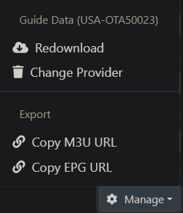

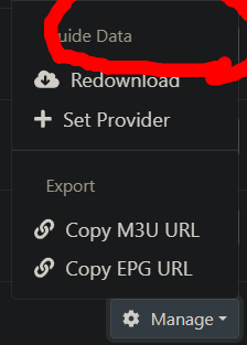

Screenshot 2026-06-13 075918
Screenshot 2026-06-13 080009
Screenshot 2026-06-13 080055

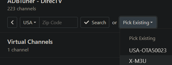

selecting X-M3U will use the info from the m3u. if you have a tvc-guide-stationid set in the m3u, remove/repace with tvc-guide-stationid=""
sorry, reread and better understand slightly
did you make this initial change? if you could make a change to the entire source, then change back to the correct using the dropdown i screenshotted
or again, just map the stationid's the way you want in the m3u
