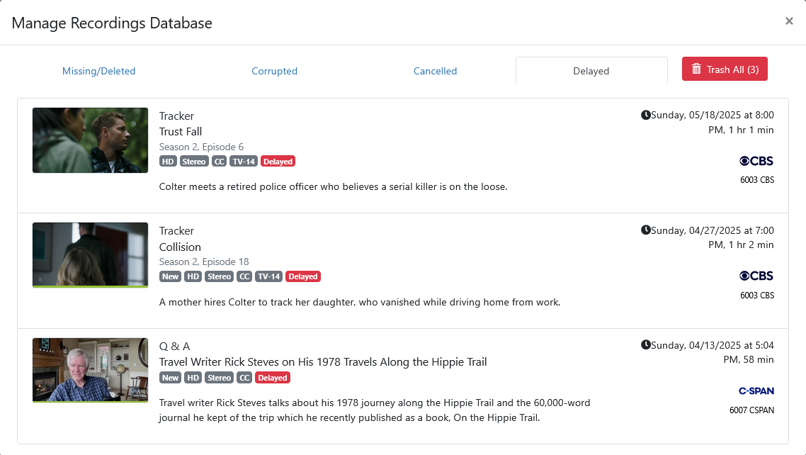

Removing the Delayed tag from recordings
Other than moving the recording to Imports, is there another way to get rid of the Delayed tag on this recording?

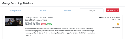

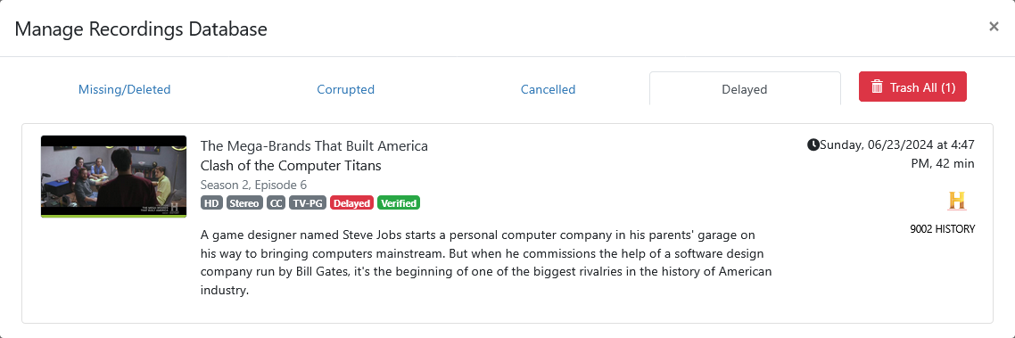

Create a curl based manual recording using the metadata for the episode, copy the original recording file over the curl based manual recording file, keeping the curl based manual recording filename and trash the original recording in CDVR.
Easiest is to copy the recorded file from TV\The Mega-Brands That Built America to Imports\TV\The Mega-Brands That Built America, rename the file so it imports correctly, import it and trash the original recording in CDVR.
Would be much easier if we could just remove the Delayed tag. But it's not an editable metadata item.

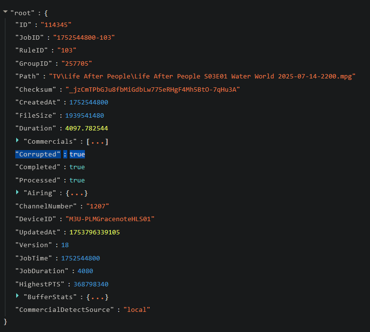

So, if you look at the file json metadata, you'll see something like this:
In this case, Corrupted is the Interrupted tag. I don't have any delayed programs to check, but assuming if you do you'll see something like "Delayed": true (please confirm what this says).
Given that, it is possible to use a PUT statement against /dvr/files/[file_id] to affect the JSON. My assumption based on prior experience with Channel's backend is not to change the value to false, but to blank it out; however, I would have to test for sure.

Correct. /dvr/files/[file_id] does not contain "Corrupted": false or "Delayed": false

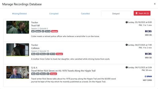

To see the Delayed recordings, use /dvr/pruner/delayed
For Corrupted recordings use /dvr/pruner/corrupted
