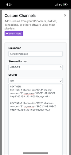

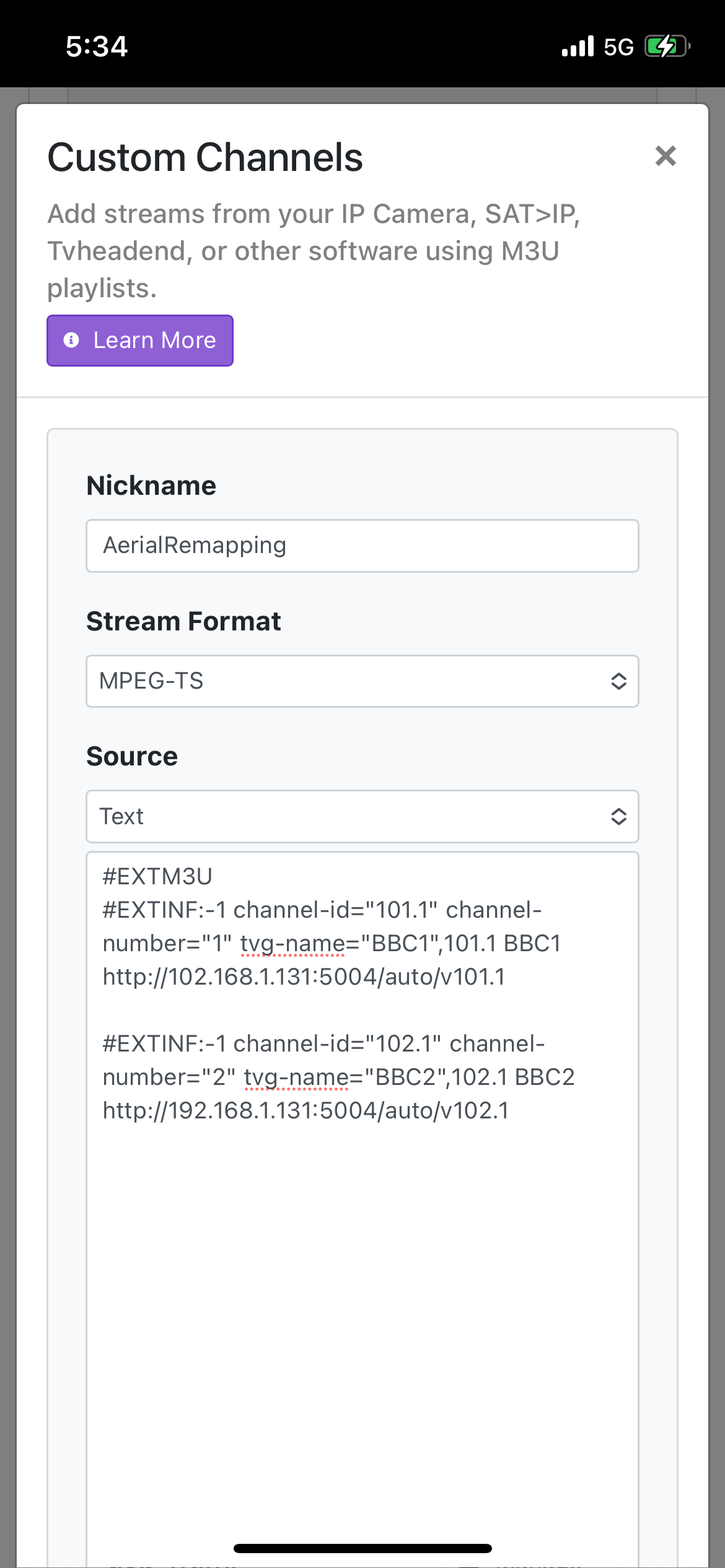

Hide the SD channels, create a custom channel source using this as a template for each channel.
#EXTM3U
#EXTINF:-1 channel-id="101.1" channel-number="1" tvg-name="BBC1",101.1 BBC1
http://ip.of.hdhr.not.server:5004/auto/v101.1
#EXTINF:-1 channel-id="102.1" channel-number="2" tvg-name="BBC2",102.1 BBC2
http://ip.of.hdhr.not.server:5004/auto/v102.1
The top one will create a channel 1 but will tune to channel 101.1 when selected. Change both BBC1 to whatever the channel is called. And so on down the line for each channel.
It should look like this in channels. In the example screenshot my ip of the Hdhomerun is 192.168.1.131

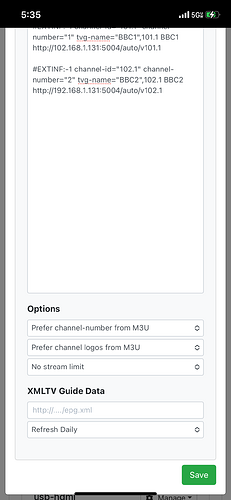

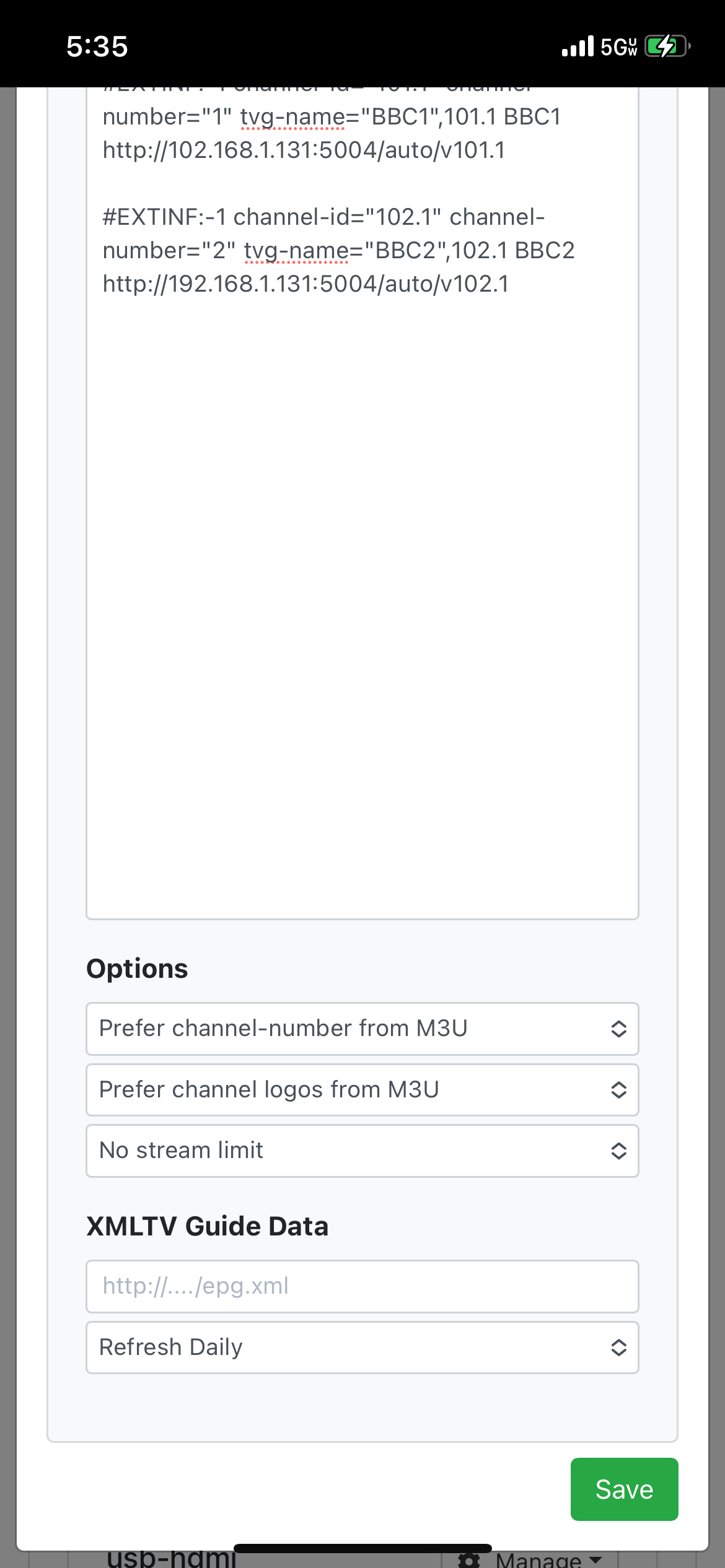

Choose prefer channel numbers from m3u. Leave guide blank in the settings. After the source is created, to add guide data select the manage drop down and select set provider and use your zip code. Then select manage lineup, then click the “+” button on each channel and assign the corresponding channel to the channel.
Finally adjust source priority and move the new source to the top row. You should be set now assuming the hdhr in the UK are the same as the states. If it doesn’t work simply delete the custom source.
