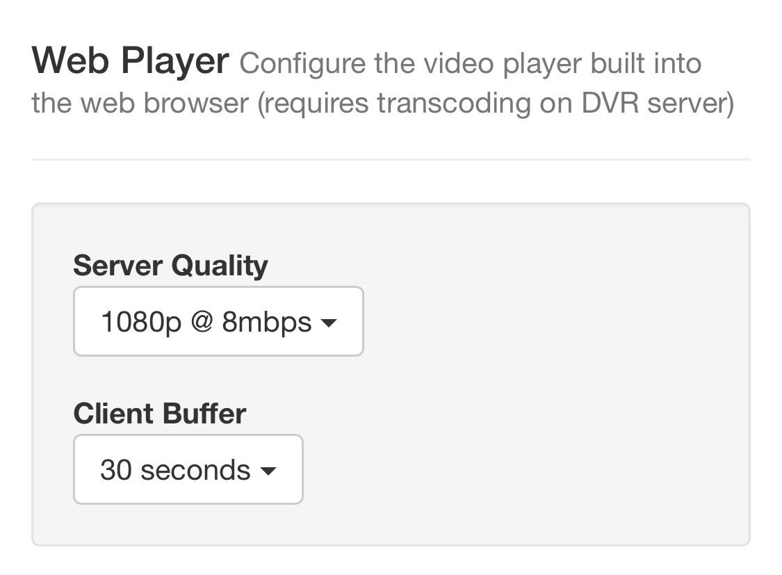

There are a few settings and depends on if you're viewing/streaming locally or remotely.
DVR web UI
Web Player->Server Quality
Transcoder->Adaptive Streaming
Experimental->Adaptive Streaming for Live TV
Experimental->Web Player Adaptive Streaming

The audio bitrate for a 6mbit stream is 192kbit AAC. The audio bitrate for the 8mbit stream is 256kbit AAC.
