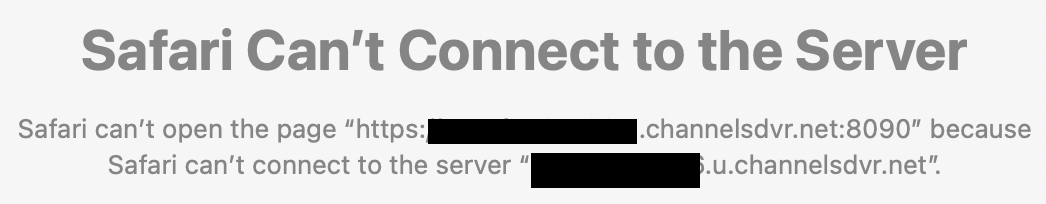

I get the following message which attempting to connect remotely.
Your Channels DVR Server at home can not be reached.
Remote Access is enabled, but we can not reach your server. Please ensure that port 8090 has been properly forwarded from your router to the IP address of the computer you installed Channels DVR Server on.
Following shown when accessing my.channelsdvr.net

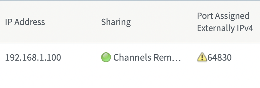

So, 8090 was showing closed but 8089 was showing open even though this wasn't configured on the router. I have opened 8089 on the router, port check still shows 8089 as being open but the router is reporting this error

Then your router is doing something weird I guess. As shown in your screenshot, its using port 64830 not 8089 or 8090
When setting 8089 and after saving the setting it errors to 64830
I would highly recommend disabling upnp on your router, reboot it and doing manual port forwarding on it if you can.
