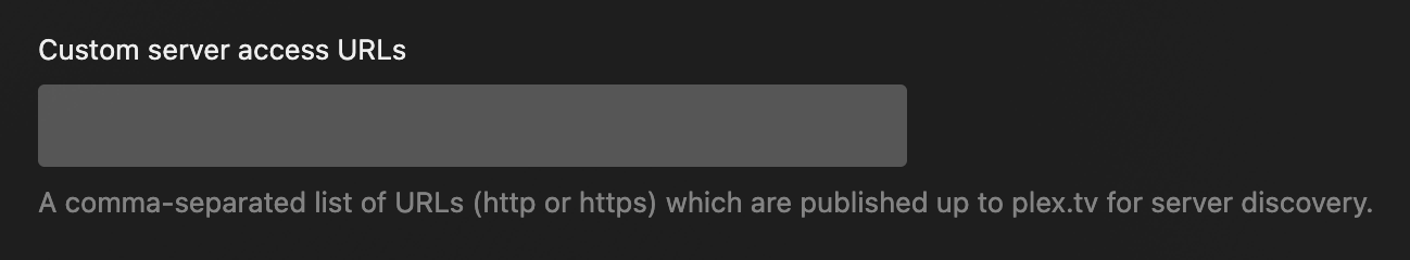

It would be great if Channels had a way for users to specify a URL that is then published to their DNS. Plex makes this easy as an option in the network settings...
Admittedly, I have no idea how hard this would be to implement, but I assume adding a network setting in the UI with an accompanying API call to overwrite the provided Channels domain wouldn't be too big of a task.

It is called a CNAME. Just publish it in your own DNS
You're missing the point, that does nothing for the app discovery or authorization.
