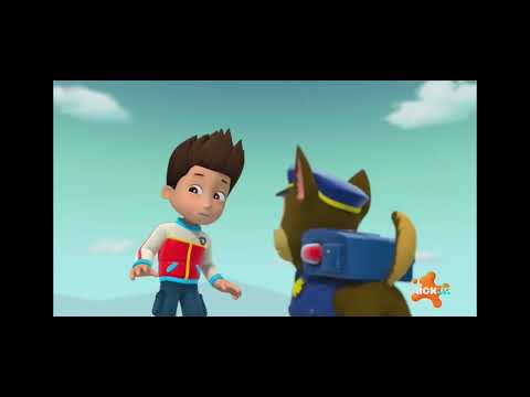

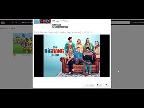

Here is a video of the Roku ECP Tuner script. It is still early and I have a lot of work to do on it, but it is a good proof of concept.

I hope the Spectrum App on Roku supports Deeplinks. I will start testing other apps once I get the little bugs worked out. Here's a better video from my phone.
edit: The video recorded with audio out of sync. The actual playback was synced correctly.
Looks like it is tuning those pretty good! Great Job on this.
