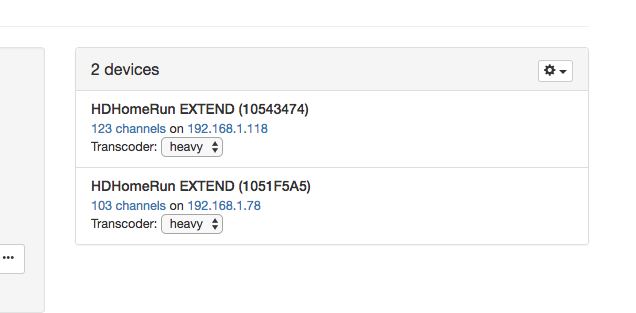

Click “Add to DVR” under your HDHomeRun
Can you supply some sort of image?
Try refreshing the page first
There is No “Add to DVR” menu item. Here is the log

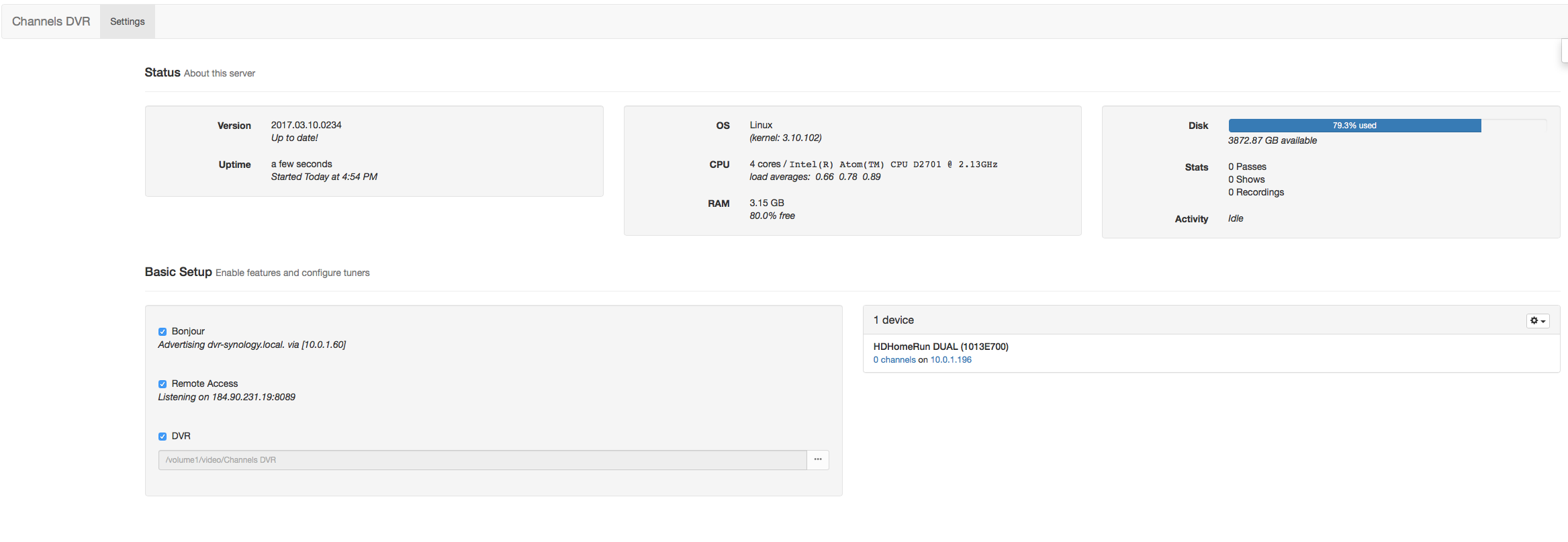

Can you take a screenshot of the settings page?
FYI this appears to be a rather underpowered model (1.2ghz ARM cpu + 256MB RAM)… I wouldn’t recommend it over your QNAP.
I do realize it is under powered but if you recall I made another post where my QNAP would go into this funky mode after two days running (would not be able to access files). Was trying to rule out the Channels DVR app but stopping the service on the QNAP and letting it run on the Synology for a few days. .
And to the left? The DVR box is checked with a recording path set?
Can you try another browser?
Yes it is checked with a path of /volume1/ChannelsDVR
Wait a minute. My apologies. Add to DVR now appears. I don’t know what happened. Sorry about the confusion.
I think there’s some bug causing it not to appear reliably. @ImNotSerious mentioned not being able to see it on iPhone browser too.

I am in the same boat. Installed Channels onto my Synology NAS and AppleTV wants me to finish setting up. I do not see "Add to DVR" anywhere. My HDHomerun shows I have 0 channels. Please help. Tried both Safari on Mac and IE on PC. I do not see "Add To DVR"
You’re using a legacy tuner, so you need to follow the steps in HDHomeRun DUAL support (legacy tuners)
Works now. Thanks for the link to rescan my channels. I see the Add to DVR now. Thank you.
