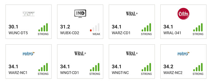

ok Roger that... now additional information... on firetv (only) not my primary AppleTV on channels grid I get the 34.1/ call letters on WNGT but it plays 34.1 WRAL+ which is the other channel sharing the 34.1 frequency..... on APPLE TV channels app 34.1 IS the WRAL+.... so adding this additional information..... so upgrading from HDHR duo to a newer ATSC 3.0 would not separate and show both???
None of those stations are 3.0. It would make no difference. Sounds like you may have some thing not mapped right in your Channels DVR server for those channels.
I do not recognize the image you posted. Where is that from? it is not Channels DVR...

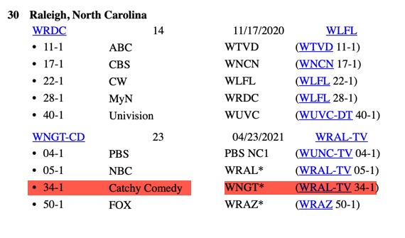

thanks for that (and quick replies) here is the issue?
34.1 I highlighted them in red... .
right now the WRAL+ news is on as I just did another rescan...
simple thought is that the WRAL is more powerful than the other one hence thats the one that is picked up.... both show on the air both show ATSC 3.0 ... now to be clear my HDHR duo doesn't have the ASTC 3.0 tuner... which is why I thought perhaps I should upgrade.

https://www.rabbitears.info/market.php?request=print_market&mktid=35
Looks like he was right. 2 stations on the same channel numbers. Odd.
And, since u have ATSC 3.0 area... why not give it a shot with the HDHR Flex 4K. None of them have DRM in your area. (assuming that site is up to date)
Edit: I guess they were ATSC 3.0 stations. I was told on here that they always show as #100 + on HDHRs though....
If you look here, WARZ-CD | TV Stations Wikia | Fandom, WARZ, Channel 34 is a low power religious station out of Smithfield, NC.
