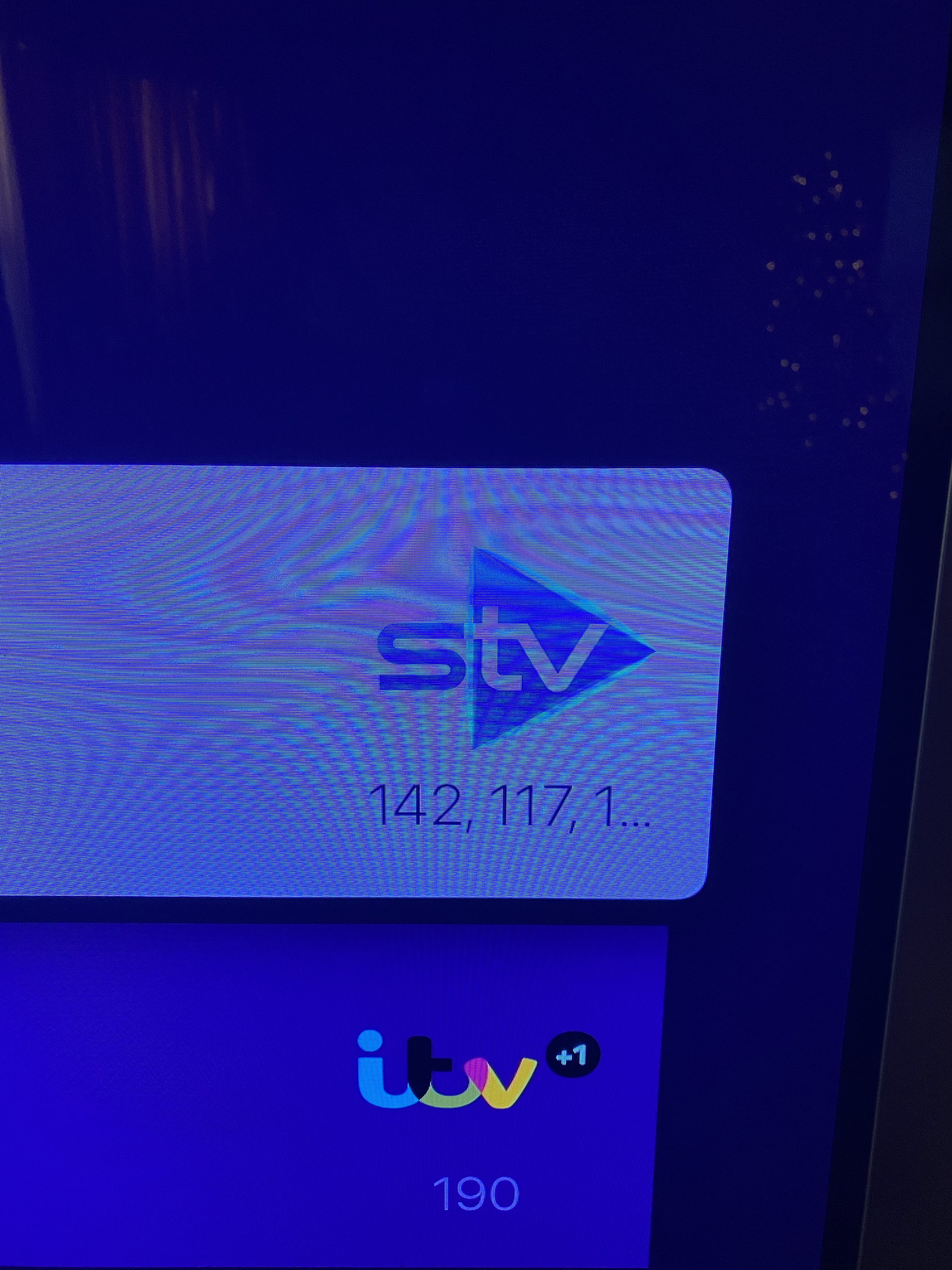

Thanks for the reply. It’s not duplicate channels. It’s duplicate shows on at the same time across multiple channels. See screenshot highest channel number is priority
Where are you getting this screenshot. Are you looking at scheduled recordings?
I got that by searching for a show. If I go to record, it shows the channel with the highest number

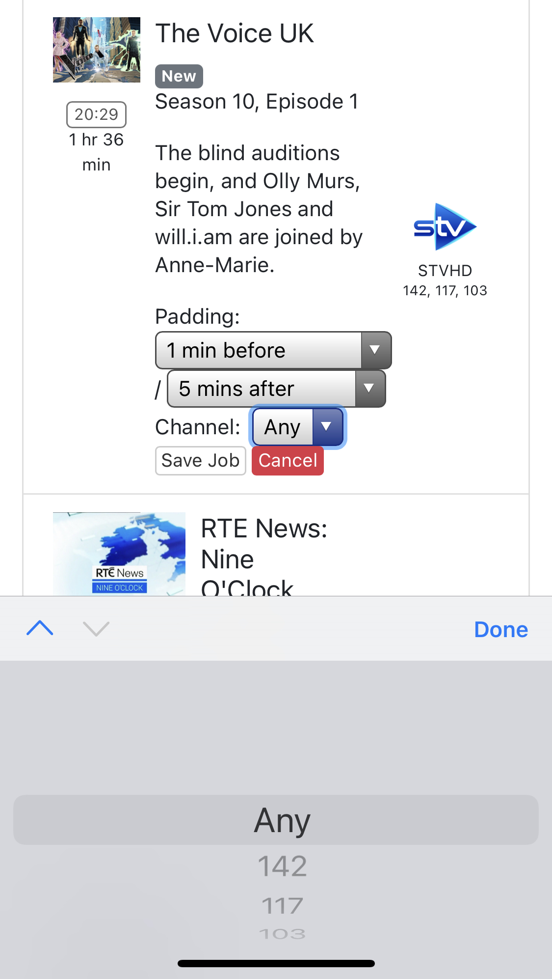

Look on the dvr web UI schedule. All three numbers show appear, and will be sorted based on your dvr sources priority and favorited/HD channels.
See image. All channels are from the same source and are in order by number
