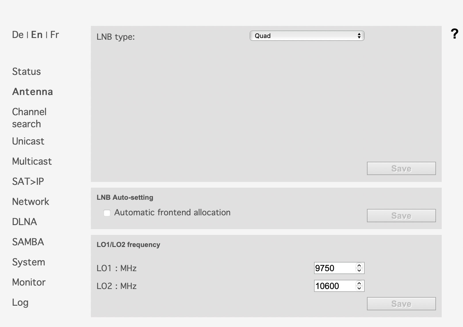

Thanks. Actually I've got it set to Quad with one single-cable. I think on the Digibit if you've got one LNB thats the advice. It finds all the channels. This did not work on the Kathrein 418, with same settings it didn't serve all the channels.

seems turning off automatic LNB selection improved the concurrent channels...
My rather basic understanding of how my box works, is that if you set either Quad or Quattro you MUST have 4 cables. Perhaps your box that only finds some channels, operates the same as mine, but the other doesn't.
If you only have 1 cable, or even 2-3 for my box, you have to set 'One user per RF' - and connect them to specific ports - OneCable is the equivalent on your box I think.
When either Quad or Quattro are set 4 cables are required, with Quattro the LNB has hardware filters, when you set Quad the filtering is done in software instead - to achieve:

Although this actually isn't my issue today (the issue is being able to serve Channels using http rather than rtsp to speed up channel selection...)... I can get all the channels on Freesat using Quad/single cable on the Digibit R1. On the Kathrein I did only get a subset of channels. On the R1, if I select Unicable (guess equivalent of OneCable) I don't get anything (and its plugged into port 1 as per the instructions).

On the Digitbit, Quad would be the right setting based on your last post. 1 cable, is basically a Single LNB. A Quad LNB, is basically 4 x Single LNBs. Quattro and Unicable are specialised LNBs.
On the Kathrein, I suspect 'One Cable' would resolve your problem.

The 2 boxes work differently and treat the 'Quad' setting completely differently. The R1 treats it as 4 x single LNBs, the Kathrein mimics a Quattro LNB, when you set Quad, so requires 4 cables in this mode. Would be my hunch, anyway.
