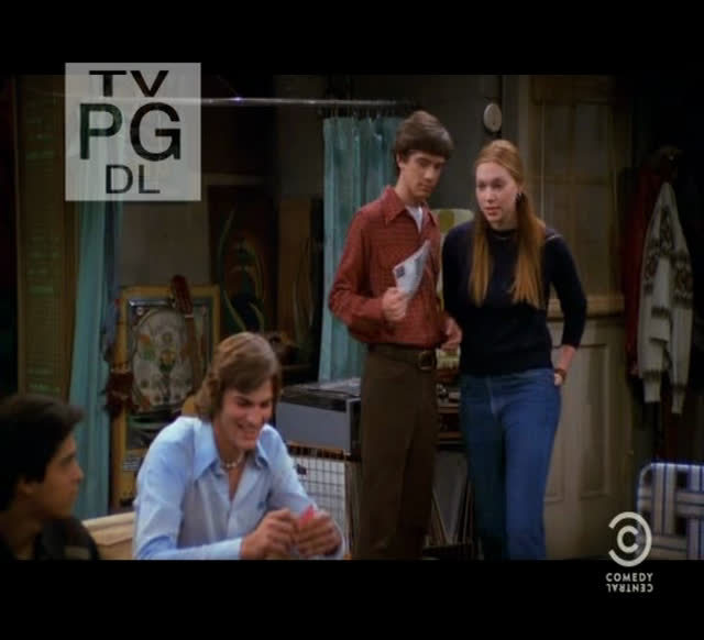

If you use that logic against 528x480 [SAR 40:33 DAR 4:3] you get an image that is 640x582 [SAR 97:80 DAR 4:3]

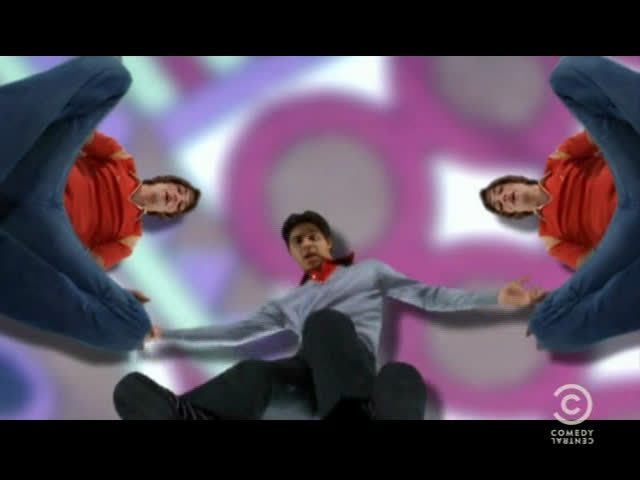

using that logic generates an icon 640x480 [SAR 1:1 DAR 4:3] which is correctly sized.

Attached are 2 pictures, 640x480 and 640x582. The 640x582 was created by your screenshot logic. The 640x480 was created by ceil logic.
