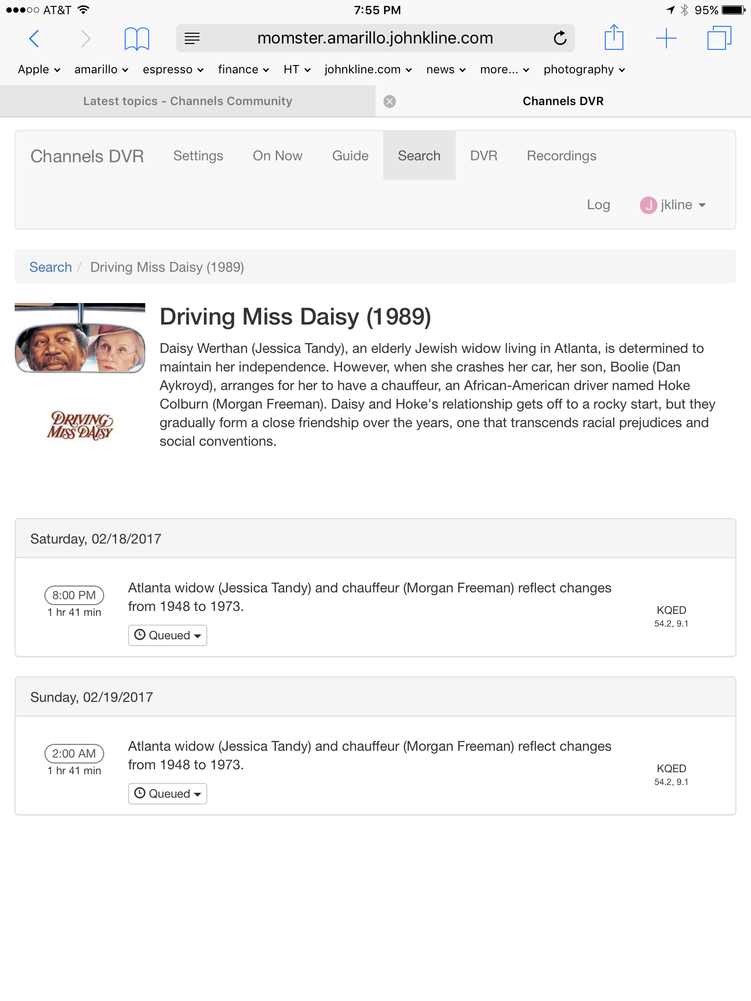

Example, see attached. Search, select movies, see "Driving Miss Daisy". Notice it's on 54.2 (SD) and 9.1 (HD). I can't choose. So I hit record. Then I have to check the queue, notice it's recording on 54.2—which I don't want, delete the queued recording, go find the movie in the guide on 9.1 and hit record again.

To duplicate, I picked a movie that is playing tonight at 10 PM on ch. 9.1 (HD and recognized as so by the HDHomerun) and ch. 54.2 (SD and recognized as so).
As I previously reported, when I select these movies for record, the DVR schedule shows it will record on 54.2 (SD).
The movie is now next up and the log is showing it will record on 54.2 (SD):

Hmm so on the web UI DVR Schedule, it doesn’t show the HD channel listed at all?
Okay I see the bug now. Sorry, should have tried to reproduce earlier.
Sounds like you already found the issue, but here's the screenshot showing the DVR schedule only shows 54.2.
