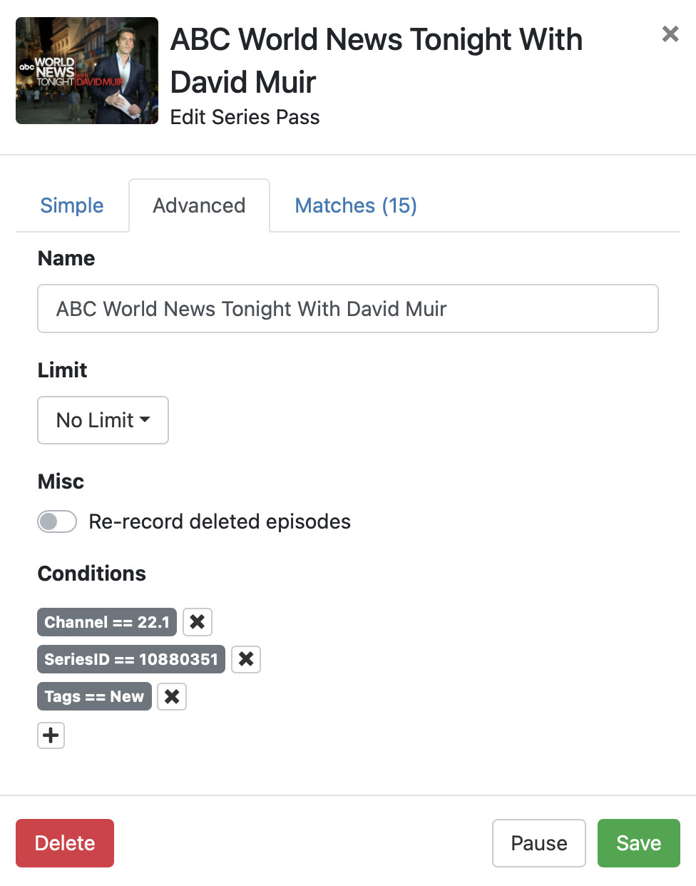

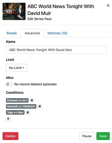

You need to give specifics and show your advanced pass if you want help.
My “advanced pass”? What the heck is that?
I posted a detailed account of the glitch I’m experiencing. The only thing I can add is that even when I change to a completely different channel, after a day or two it automatically reverts the pass to the (wrong) channel it was using previously. This happens even when I delete the pass and create a new one.
Specifically, my original pass was set to record from channel 9.1, but it kept changing mysteriously to channel 9.2 – where the program never airs. So I deleted that pass and created a new one recording the same program from 22.1. This worked for a day or two, but then it mysteriously changed back to 9.2 – no idea why.

Try this in the pass advanced tab:
Channel > 9.0
Channel < 9.2
I also do that so I don't get ATSC 3.0 recordings using something like:
Channel < 99
(because ATSC 3.0 channels are always 100 or higher where I live.)

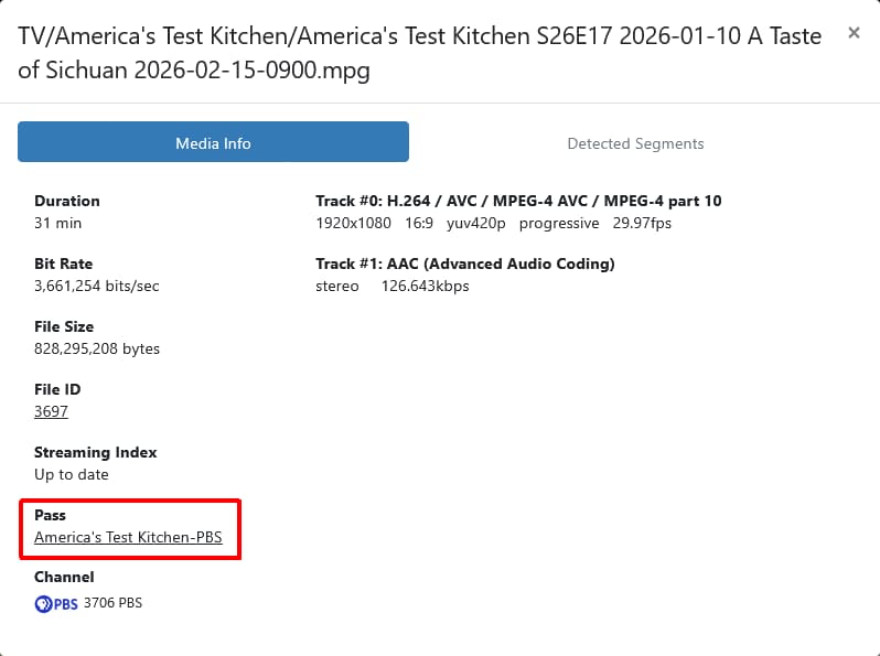

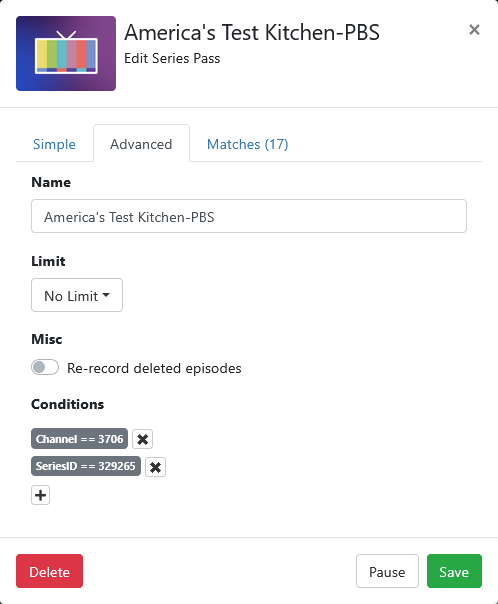

You could have another pass setup that's recording from 9.2.
You can check the recording made to see which pass recorded it.
Clicking on the underlined pass will display it
