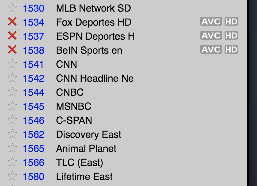

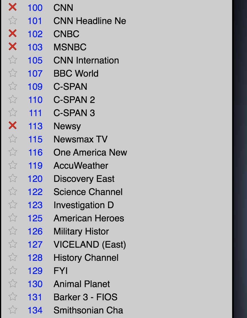

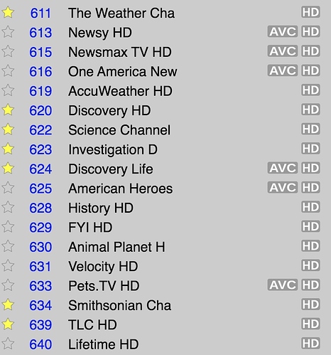

If you open my.hdhomerun.com and click Channel Lineup, only channel 620 is listed as "Discovery HD".
The other two channels are listed as "Discovery East", and are not HD channels. So the DVR is not selecting the HD channel.

Here you go. Attached are screenshots of the HDHR Prime Channel setup.
As you can see, both channel 120 and channel 1562 are SD channels.
Only the HD channel 620 is marked as a favorite.
The DVR is grabbing a nonselected SD non-favorite channel 1562 over the selected HD favorite channel 620.
Only channel 620 is an HD channel.
