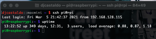

I have an rpi4. I don't actually use it for Channels, but I do run various other important network services on it (which are never offline).
