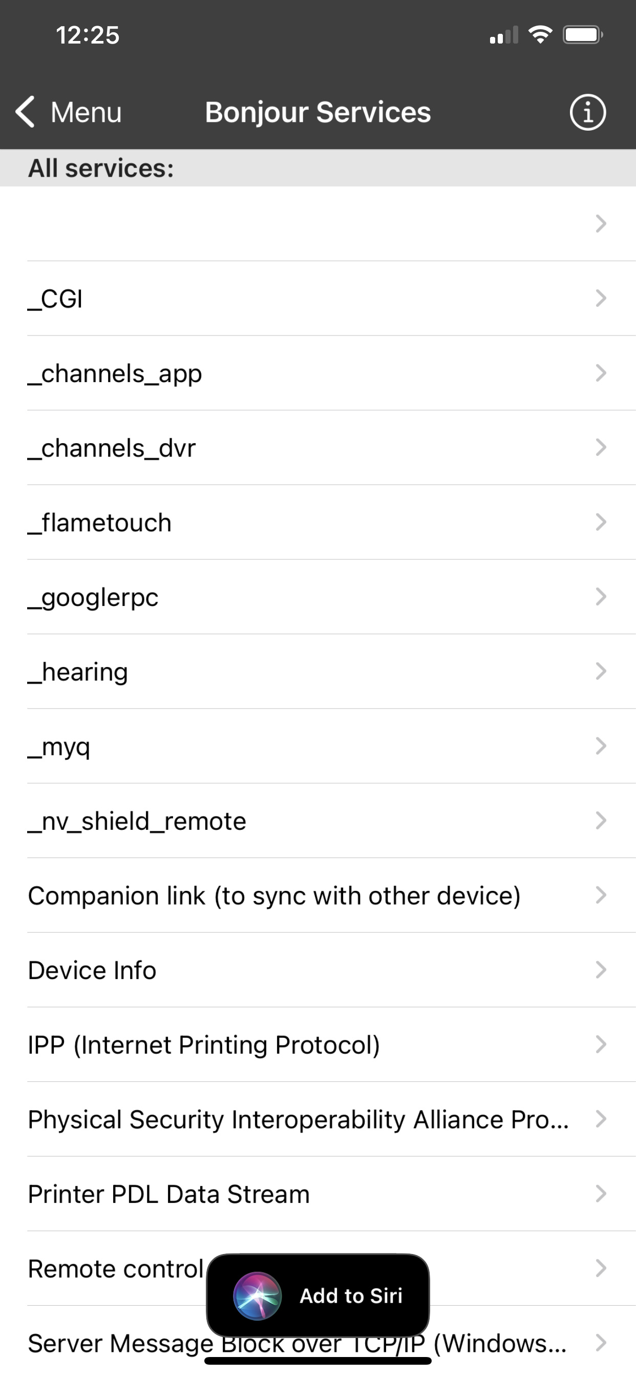

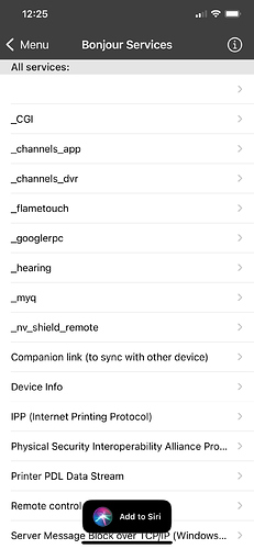

Bonjour is picked up by a browser on my iPhone, _channels_dvr._tcp, and clicking on is show the name of my server computer. I am stumped.

Using the bonjour browser on my iPhone, I can see both channels app and channels dvr.
