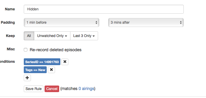

So I set the pass up like so:
And save it. In the past I didn't think I had to do more than that, but no they don't show up in the schedule so they obviously won't record. You have to go to the item in the guide and hit record

You can use the advanced editor in the web UI (click the gear dropdown on the right of the pass) and it will show you how many episodes match the rules.

On the DVR web page, click under Passes and then click the gear button to the right of the pass

In the advanced view, next to the save button it says “0 airings” which means the rules are not matching any episodes.
So what do I need to do? It’s found the correct series. All the info seems correct?
Try clicking the X next to “Tags == New” and see if that changes the “0 Airings”
Also try to find “Hidden” on the search tab, click in and see if it shows episodes. If it does, copy/paste the URL from the browser.
Removing the tags == new does make it show up a recording. But only currently the next one. But that’ll do for now. What do you think is going on here?

Sounds like the guide data doesn’t have the episodes marked as New?
Do a search for the show and look at all the upcoming airings. Do they say “New” next to them?
