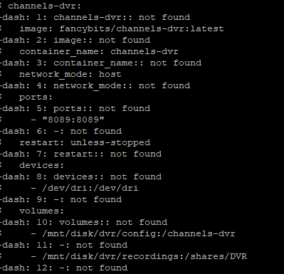

I tried the Docker version with the following result:
If it isn't obvious I have little experience with Linux but am sure that it is something that I can get up to speed on.
OMV is a Debian Linux application.
You seem to have the DVR installed on your windows PC. So first run the installer there and uninstall it.
Then run the Linux installer on your NAS. The docker stuff is much more complicated and not recommended unless you have experience with docker.
