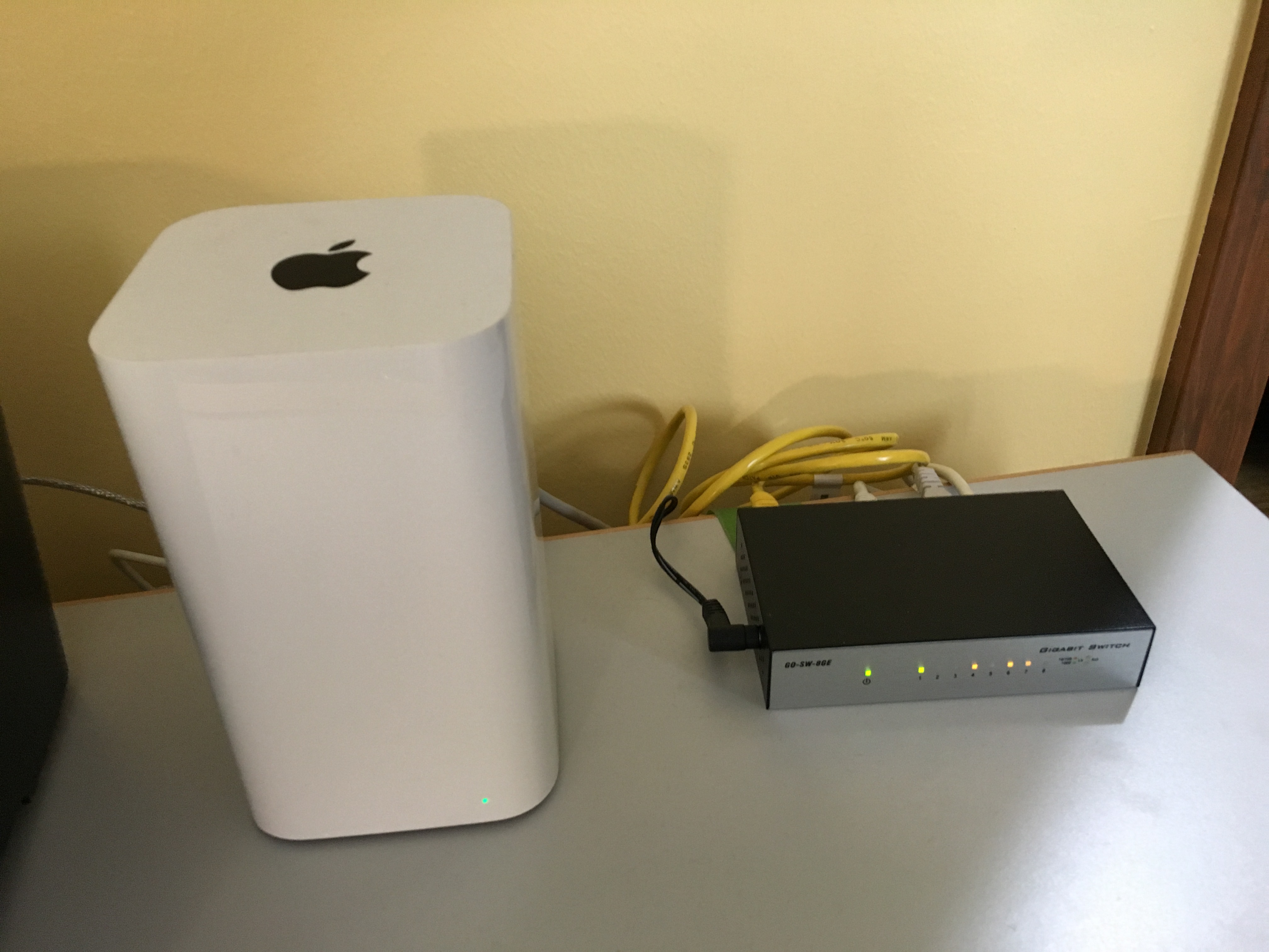

WiFi performance has not been an issue. I use an Apple Airport Extreme which supports 802.11ac and this has proved fast enough.
My Apple TV’s are all the fourth generation version 32 GB which has 802.11ac. Two of the Apple TV’s use WiFi and one is using wired ethernet.

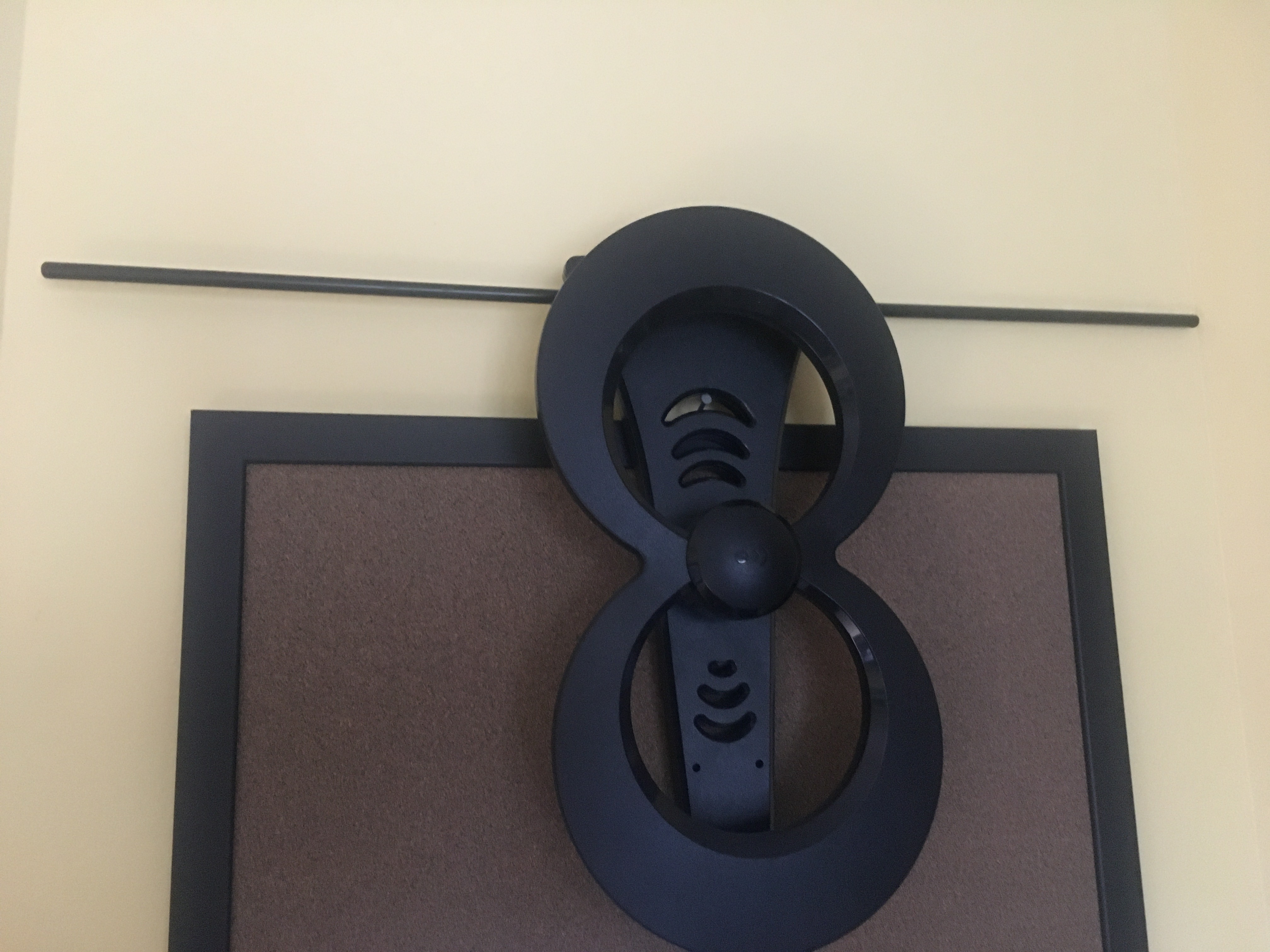

So by adding to what I already had back in 2016, I now have six indoor antennas mounted to a cork board I had in my 2nd floor office. Really by luck, I have a wall to mount these antennas on that points directly to the broadcast antennas about 17 miles away. I have three Dual tuner HD HomeRuns so that gives me a total of six tuners, one tuner for each antenna. One Dual tuner HD HomeRun is devoted to the EyeTV software so I can record two shows simultaneously. The other two Dual tuner HD HomeRuns are used with the Channels software on my three Apple TV’s. So with four tuners for three TV’s, one is never without a tuner for Channels to use. I used the Signal GH iOS application to fine tune antenna placement.
Yes, it’s a lot of cables with six antennas, an amplifier for each antenna, three Dual tuner HD HomeRuns and an ethernet cable for each HomeRun, but it’s mostly hidden behind a rolling file cabinet.
I could have gotten by with fewer antennas but for the weak signal strength of FOX in my area. I could not maintain the signal strength needed for FOX when splitting a single antenna connection to the Dual tuner HD HomeRun.
