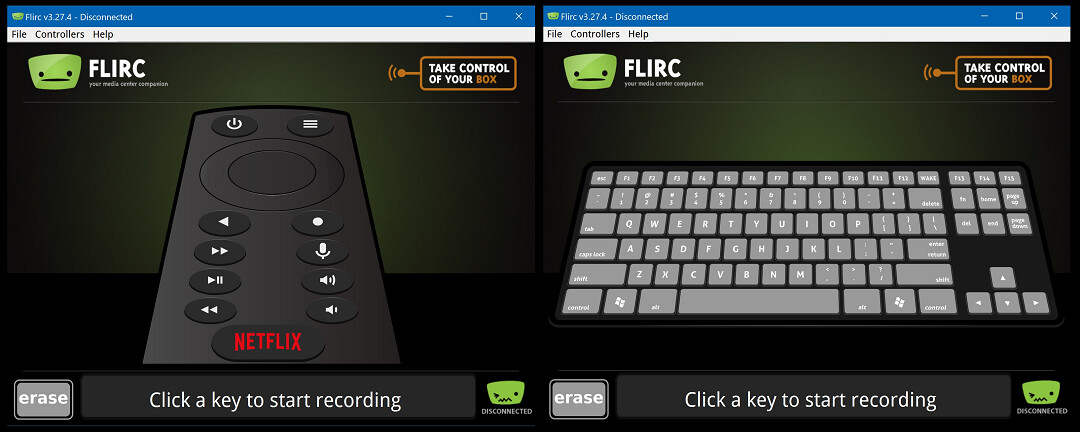

It works great. I previously used my FLIRC to map Shield commands from my URC remote.
Now, I've used the same FLIRC to map Keyboard commands from my URC remote.
Added everything in the guide, including the red/green/yellow/blue and numbers.
