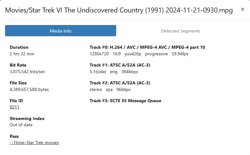

@sceptic101
Is it a UK FTA channel?
What does Channels DVR show for the details of the recording.
Options > View Details
Yes this is from a UK FTA channel. Unfortunately I wiped all the corrupt/short recordings I could find last night so I am unable to check the recording details now. Since I turned off Ad-detection I not had another corrupt/short recording, but will need a few more days of testing to see if this fixes it definitively or not.
