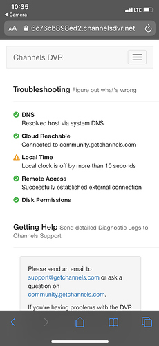

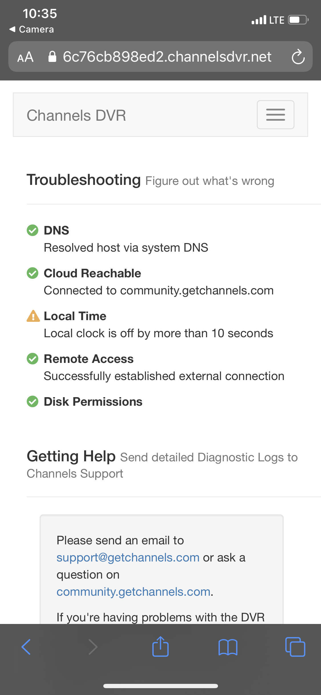

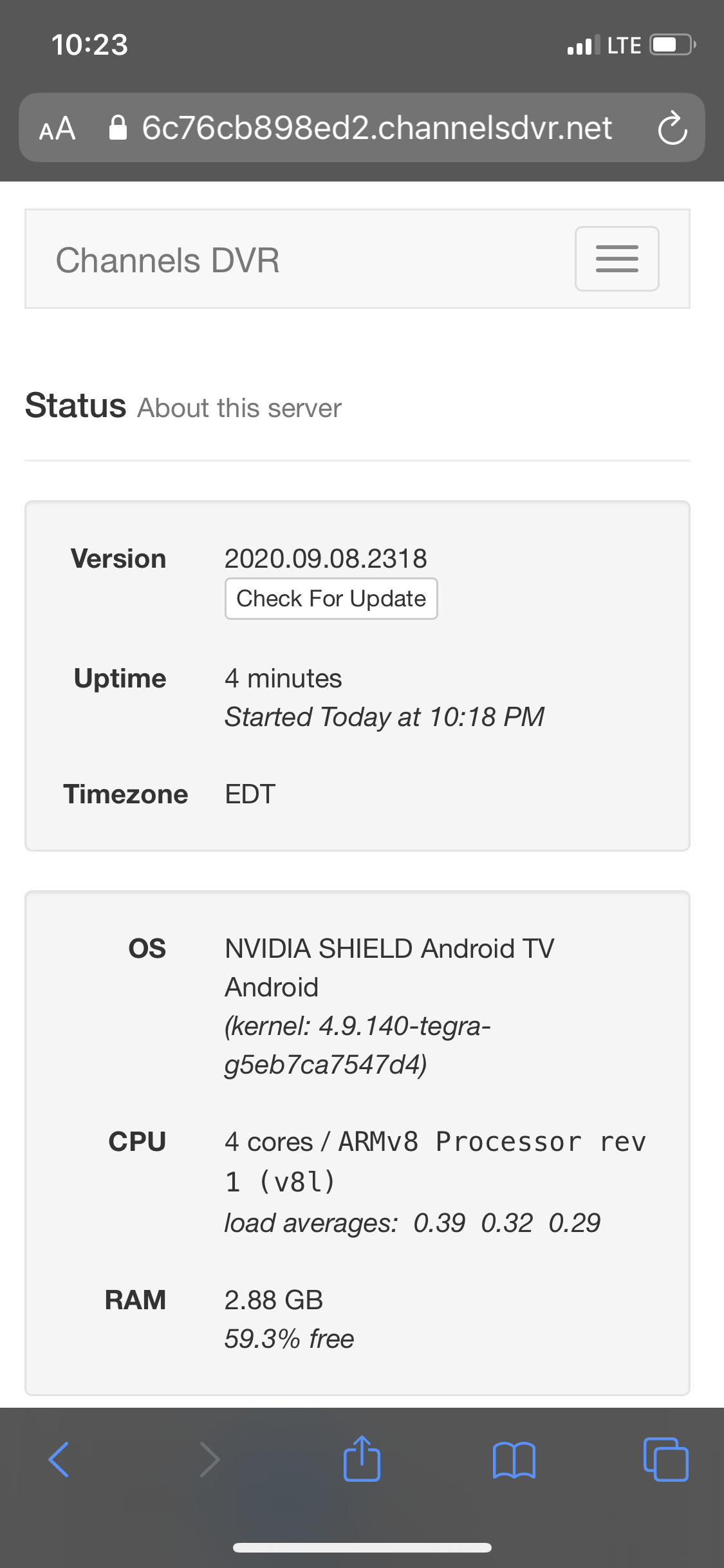

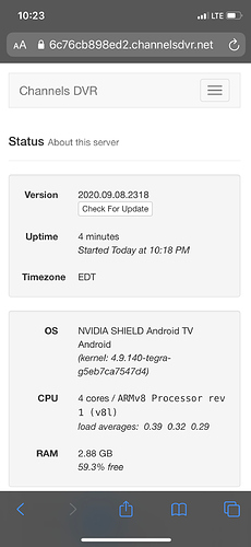

I think I spoke too soon once again. The cutoff recording time errors are back. Now I see this under the troubleshooting tab:
And this from the Server Settings page shows the time as it is locally (10:18pm) when I did the update, even though I changed the time on my Shield which hosts the Channels DVR Server to EDT (4:18am) where the TVE is authorizes from.
Where does Channels DVR Server itself get its time from? Is it not from its host (Shield, PC, NAS, etc.)?
And the shield is still showing the time zone set to what you put it to? I’m not 100% on how Channels determines time zone on the shield, the Devs will have to comment on that.
Time zone has zero effect on streams. It is purely cosmetic.
OK, so what could possibly be the issues then? Isn’t there any clues in all the log entries I posted?
