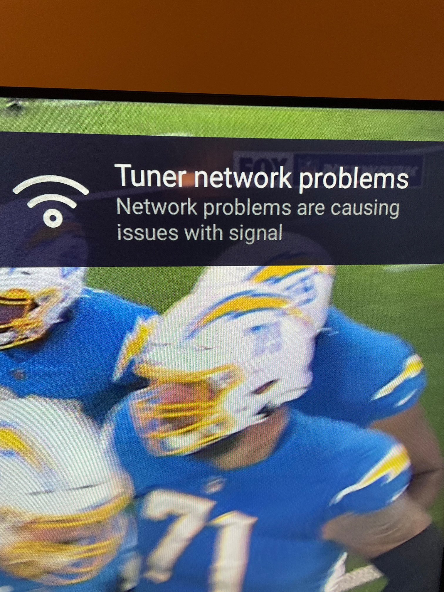

I keep getting signal network errors on my shield TV using HDHomeurn OTA’s. On the Apple Tv I never lose a signal. Any thoughts on how I can resolve this? Thanks
Are the devices connected via wifi or Ethernet?
Both connected by Ethernet
Do you have tuner sharing enabled on the clients? Also, is the HDHomeRun connected to the same switch the clients are connected to?
I do not have tuner sharing enabled.
My HDhomerun is connected to my 4-port router along with my clients.
Interesting. I assume you’ve already tried rebooting the Shield? What is the exact text of the error that appears?
HDHomerun had a firmware update and seemed to cure the problem. Going to monitor for the next few days. Thanks for helping out.
Still getting network issues. Only happens on my Shield TV. Channels DVR running on Apple Tv does not have this problem.
Try disabling the shields native “live channels” app. I had very rare pop ups and haven’t seen one since disabling that app. Probably just coincidence but worthy a try
I’ll give it a try. Thanks
Crazy, disabling Live TV app which I don’t use seemed to work. Thanks for the tip!
