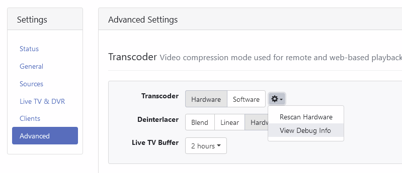

Feature request - add a simple HEVC diagnostic that can be run to determine if a given Hardware/OS platform can successfully encode HEVC streams using the channels software installed. This would be better than the trial and error situation that exists now.
That diagnostic does not show any kind of successful transcoding "in practice" .. My server hardware with an Intel 8500T which is a quicksync capable processor for HEVC , shows a successful encode diagnostic using VAAPI -- yet it does NOT work in this application when you enable HEVC transcoding. The server just stops transcoding. Apple hardware with the same processor (using Apple's videotoolbox driver technology) works fine for HEVC encoding. So there seems there is a ffmpeg issue in play. It would be useful to have the server encode a small mpeg file and see if what comes out of that process is usable by the server and then flag the environment as HEVC capable.
aapi+deint
