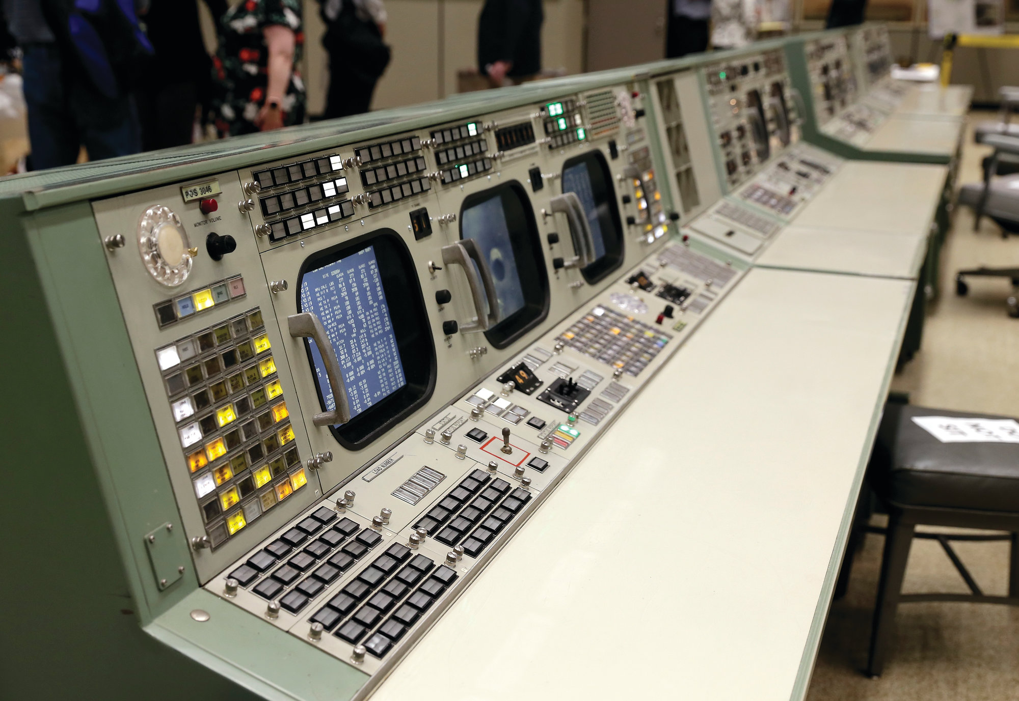

We should all be watching tv like Mission Control operators!
