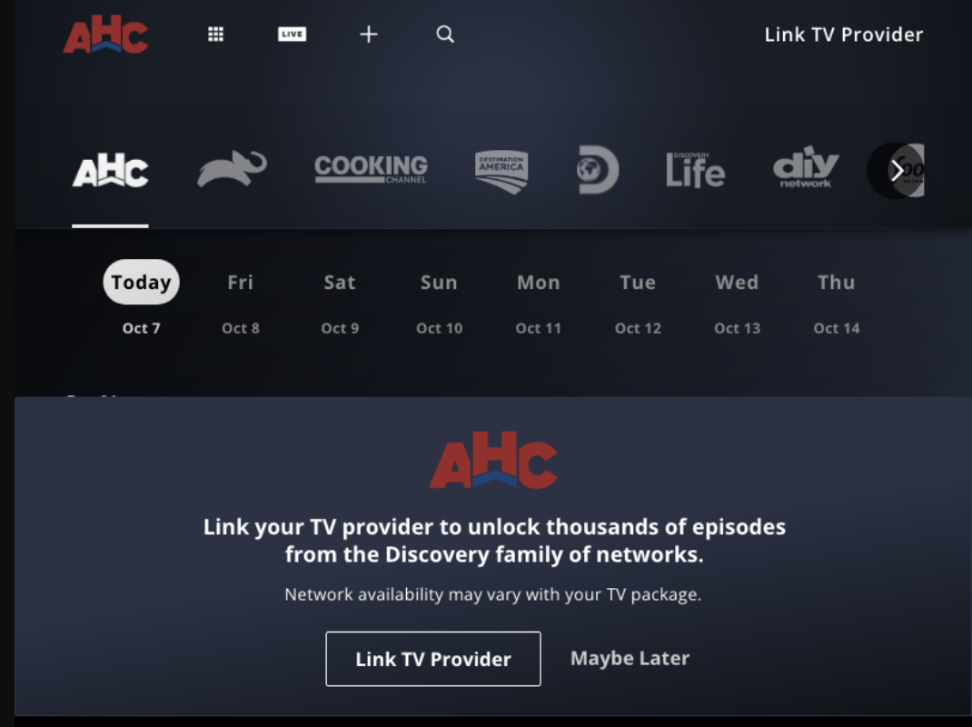

Does http://10.20.1.2:8089/providers/tve/error_screenshot.png show any YTTV page or errors
Hard to say with limited info. Did moving DTV first help? Maybe you need to do it on the client too.
