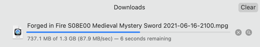

This is the output of the file you asked me to download from a computer connected to the same node as the Shield.
The result is clearly significant considering where I started yesterday.
Playing the file from the share using VLC starts immediately. Whereas it used to buffer before.
